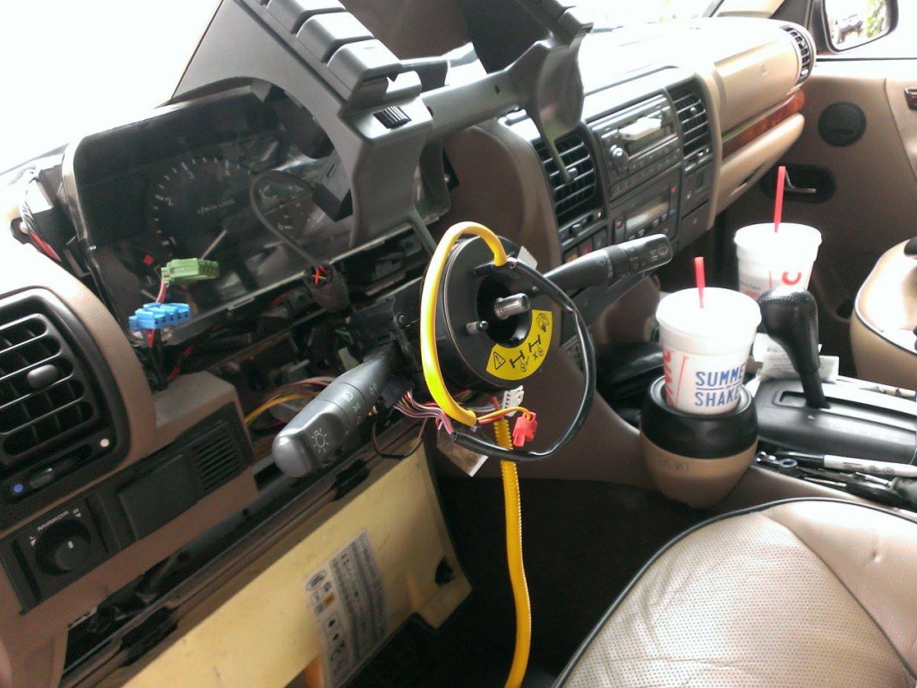

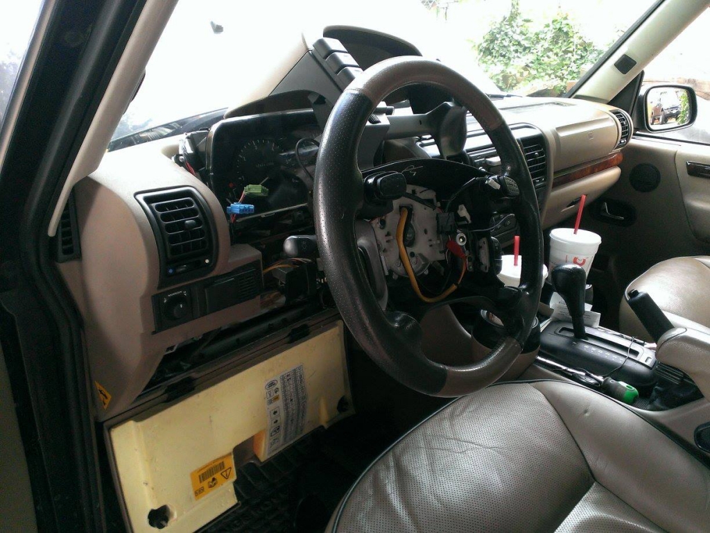

    Spent a little time working on the Disco 2 today.
    For the last few months the SRS light has been on, and as I got my Nanocom Evolution last week I found it was a faulty rotary coupler behind the steering wheel causing the fault (Open Circuit, Drivers Airbag)
    As a new coupler is around $300 from Land Rover I went over to Pick-N-Pull as they had a fairly complete 2001 Disco, while it was certainly a risk that this one would also be faulty I nabbed it for 17 bucks, as well as a new horn button (mine has been broken since I bought the Disco) as well as a spare ignition switch, rear sunroof switch (mine was just gone) and a few other odds and ends.
    Airbag out
    Replacement Coupler
    Success!

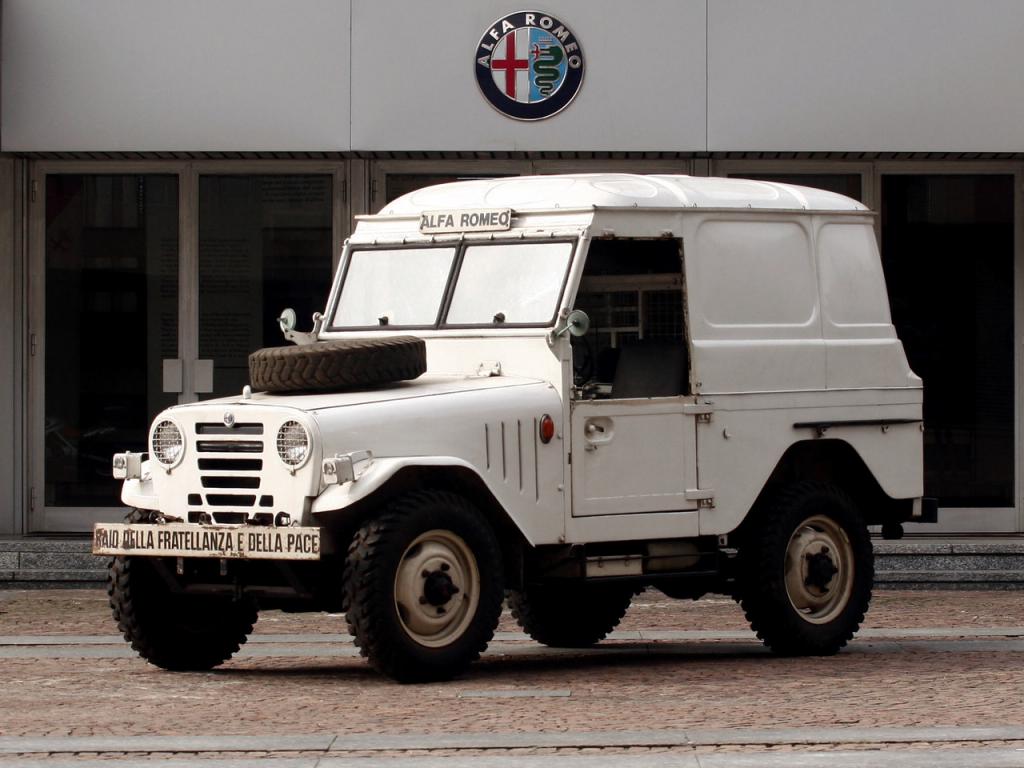

          ..and an Alfa Romeo to shake things up..

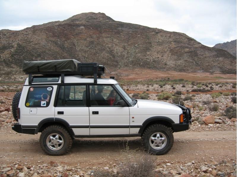

                  D1 flares
                  Nice D1 on Expedition Portal...
Name:	D1 - paint or flares.jpg
Name:	D1 flare canopy.jpg
                  My son and I have been trying to learn what we can about D1 factory flares. Not much out there. Some guys cut up D2 flares to make them work and it works..ok.. The wheel wells are completely different.
                  There is a dumb-looking factory flare that is pretty flat, and just turns into the rubber side moulding. I don't like it.
                  But this one looks like a factory piece -
Name:	fl 4Richersveld4.jpg
                  Any ideas out there?
