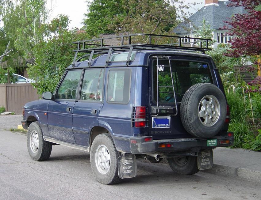

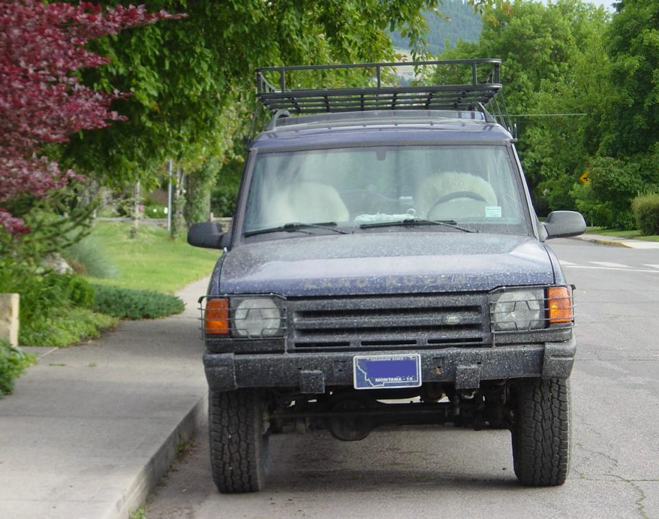

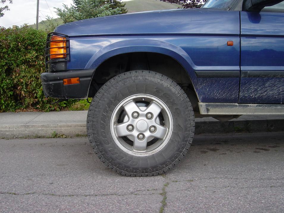

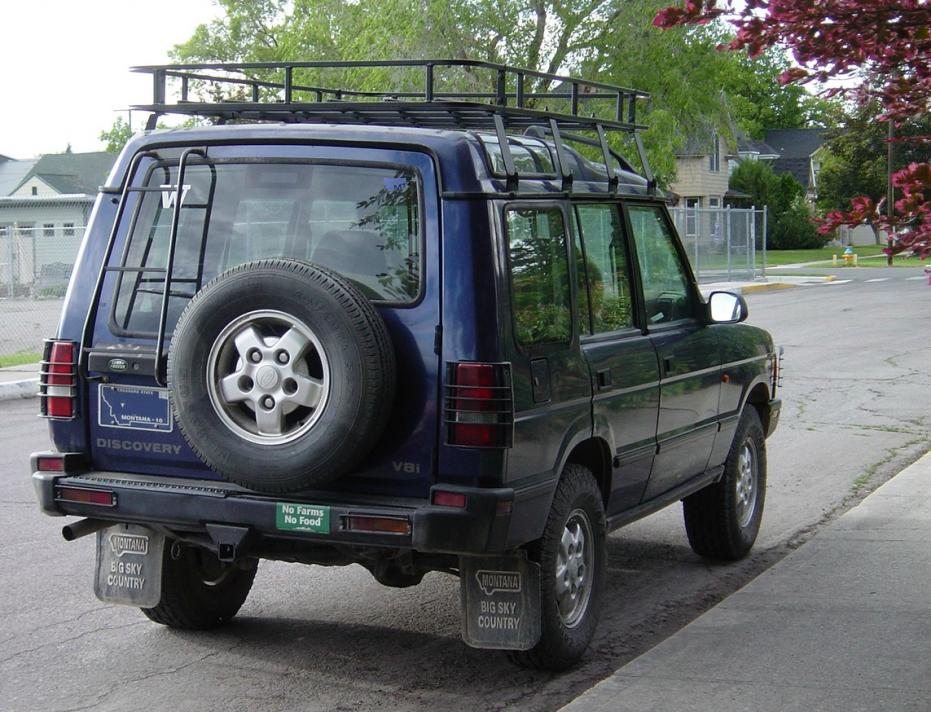

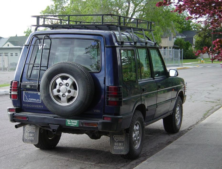

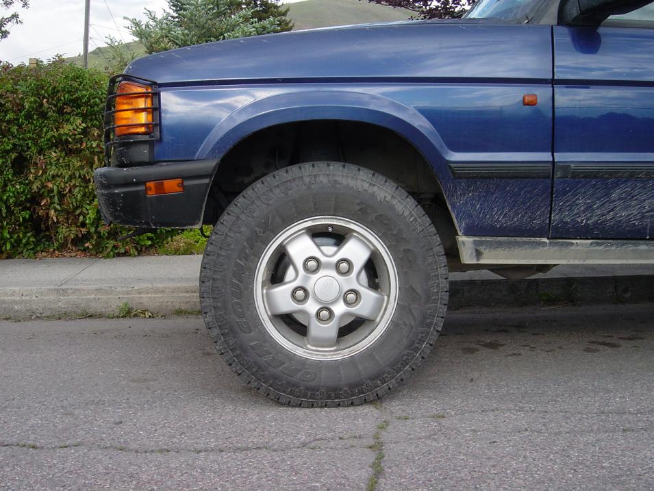

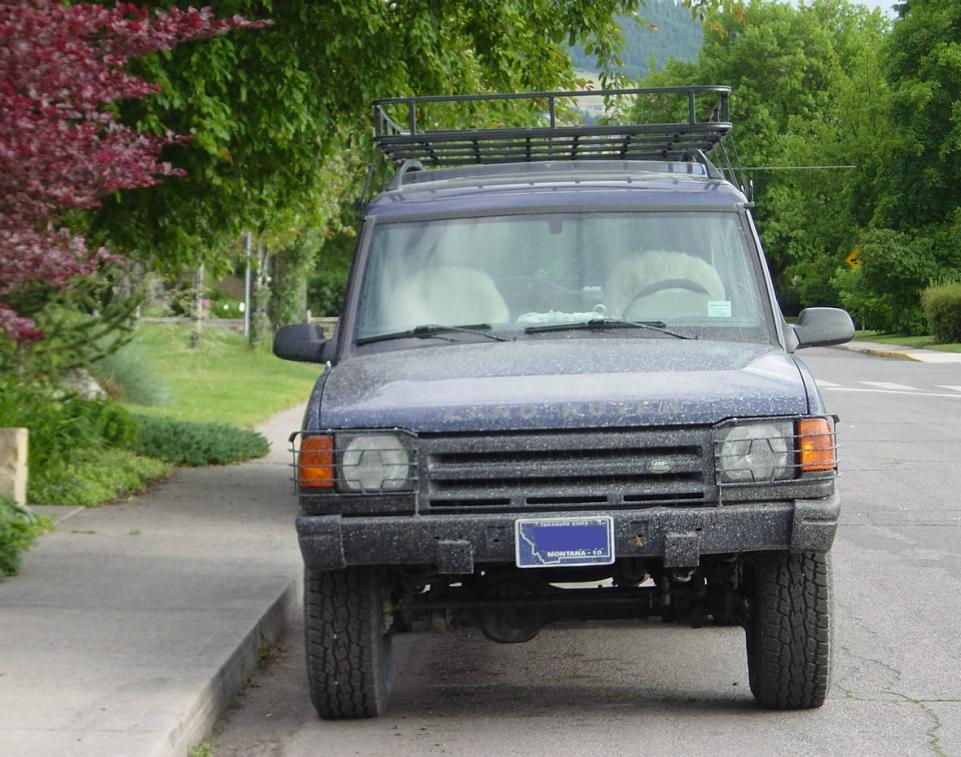

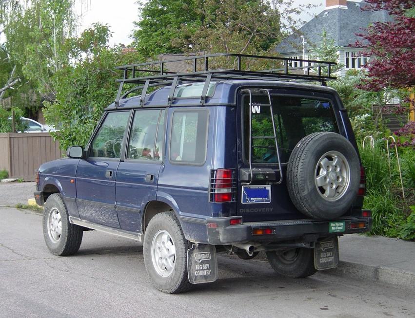

              My older son's D1, just back from weekend camping..
Name:	Mod Front.jpg
              He's been happy with this new Toyo / Les Schwab tire. E rated. Good in rain, good in snow, good on dirt, and 50,000 mi life we're told. Plus Les Schwab dealers all over the west.

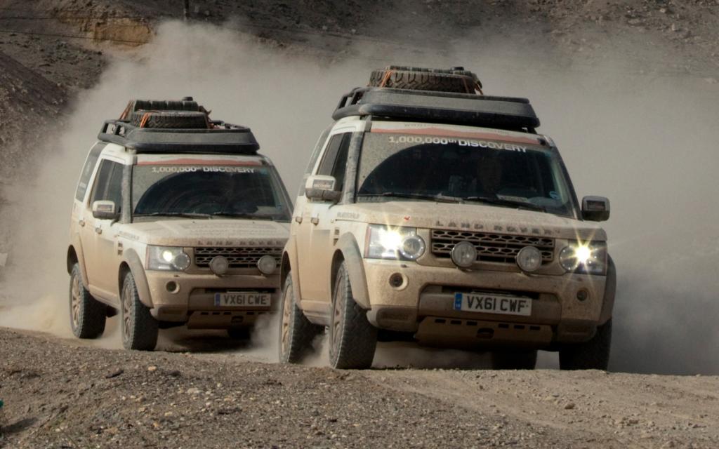

Name:	JoD 1000k Disco.jpg
