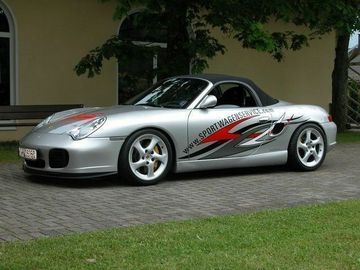

    Originally posted by Max S
    German link, but maybe you can find a translator:
    Boxster with GT3 Cup-car's engine, throwing 400hp at you.
    Max
    That looks like a monster and I would love that!
