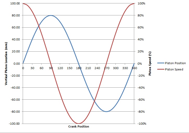

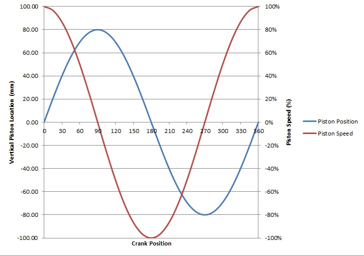

          Yep. The position of the piston is effectively the sine of the angle of the crank multiplied by the stroke, plus the rod length. The derivative (or rate of change) of position is velocity, and it definitely crosses the X axis. Here's a graph showing what I'm talking about:
