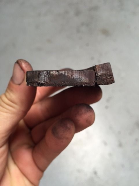

        My Raybestos st43s actually cracked after last week's track day at Buttonwillow Raceway. Was around 100 degrees outside. I've ran the st43s for a couple of years without problems, but this calls for a change. Just bought PFC08s and swapping Girling calipers for Ate with all the brass stuff. Already running brake ducts and stock rotors. 2600lbs s52 track car. Will be running Autoclub Speedway next weekend on new setup and will update after.
        Here's the st43 after last week.

            Ran at autoclub speedway today on new pfc08s. Felt good, didn't fade, plenty of stopping power. Rebuilt ate calipers and brass bushings were also an improvement over the girling calipers I had.
