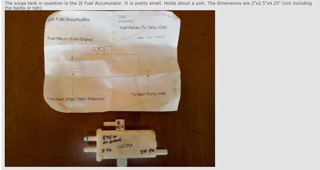

                          Anyone running an under-car surge tank?

                            • bradmer
                              • May 2016
                              • 362
                              I have this installed and it works great. No more dead pedal on long right hander's at half a tank.
