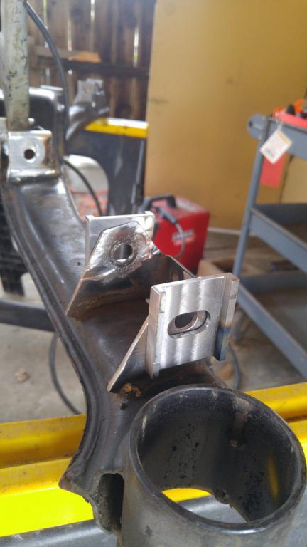

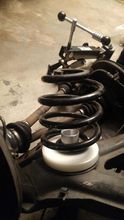

                    I gotta problem with excessive rear tow in.
                    I am on H&R Race Springs, Z3 6-cylinder trailing arms and hubs and some home-made risers to allow the old e38 Style 5's to fit (mock-up with H&R Sport springs):
                    Click image for larger version  Name:	gp2hcN1h.jpg Views:	0 Size:	42.5 KB ID:	9869541
                    I installed some adjustable TA brackets on my car, with the toe centered:
                    Click image for larger version  Name:	W1Iemnmh.jpg Views:	0 Size:	38.5 KB ID:	9869540
                    The car is at essentially stock ride height, and I have the toe fully adjusted out. Yet my rear wheels are toe'd in something stupid, making for a twitchy drive:
                    Click image for larger version  Name:	MAiS1Rqh.jpg Views:	0 Size:	67.3 KB ID:	9869542
                    Will toe angle change with the angle of the trailing arm to the car? (is the trailing arm mounted square to the center-line of the car?) Would lowering the car a bit help things? Do I need to just re-weld the adjustment brackets based on the current geometry?
                    I'd love to make a solid model in SolidWorks to play around with the angles, but I'm not sure how to make accurate models of the rear subframe, TA, etc.

                      #42716
                      What risers? On the subframe? Also I think you're supposed to go with Z3 1.9 trailing arms because the six cylinder ones are too wide.
                      If nothing else, you will have to reweld the toe adjustment further to the right (?) so you can pull it back further and dial in the toe.
                        I made an aluminum sleeve to sit on the lower spring perch nub, the sleeve keeps the riser pad(s) centered and allows me to stack higher than I would feel comfortable if I only had the nub. Then I made some HDPE disks to use as risers. Now that the fenders are rolled, I can lower the stack height, maybe even go back to just stacked spring pads.
                        I know the Z3 axles/wheel bearings come in 3 sizes (4-cyl, 6-cyl, and M), but I had no idea they came with different track widths. Can someone back that up?
                        This is what I what I want to avoid. It just doesn't make sense because I had this setup on my vert, but without the adjusters. On that car I had excessive camber but toe was within stock speck. Now I have corrected the camber, but the toe is in. I guess I need to sit down and think about how everything is related (TA angle, camber, & toe). Unless someone has an alignment rack I could use to experiment on?!?!?!

                          #42718
                          I'm gonna go with the 6 cyl trailing arms being the issue somehow. If you search, I see people doing Z3 1.9 full assemblies or Z3 6 cyl hubs and bearings on E30 trailing arms. But never Z3 6 cyl full assemblies. Is the toe issue on both sides of the car? If so that would point to the trailing arms I think, seeing as both sides are identical, rather than something being bent or your welds being off. Especially considering you said the same settings were fine on another car w/o Z3 trailing arms.
