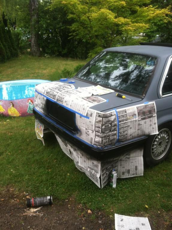

                    Another day of masking and painting! Click image for larger version

                          Maybe halfway done masking, so much frucking trim on this car! I'm ready to go to bed lol
