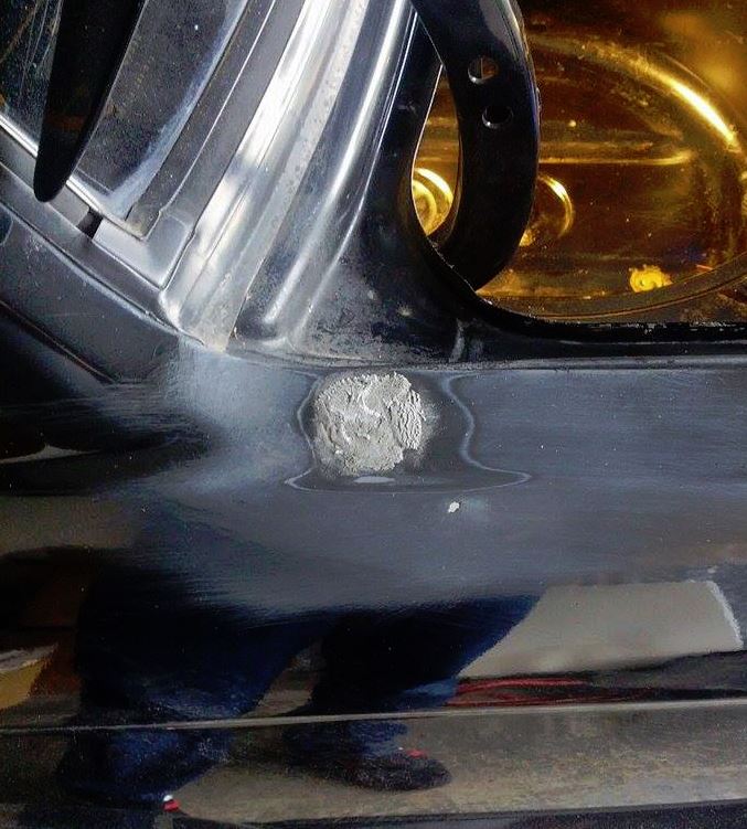

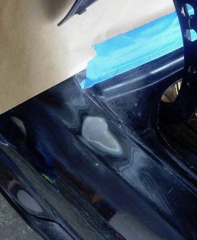

                      shit, forgot i was going to de-badge the car today. i got side tracked fixing more rust.
                      entire trunk is now rust free and seal/primed and ready for real paint tomorrow. had a few rust holes underneath my trunk lid seal that were leaking water into the trunk, all fixed now. i'll post trunk pics tomorrow when it's all painted.
                      also did some cosmetic work today, shaved my antenna. i removed the antenna and sanded the area.
                      i bought some wire mesh screen door repair kit stuff. i used jb-weld to secure it inside the trunk and let it set for 20 minutes. and then i used some steel stick on the external part and smashed it down into the mesh/jb weld. shaped it a little, then let it set for an hour. giving me this.
                      then once it was as hard as a rock, i got a foam sanding sponge and went to town on it. now i have this.
                      need to prime it and wetsand it, but it's going to look like i never even had an antenna :)
