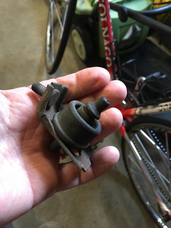

              Repeat post in a couple of NW forums. Looking for the stamped steel rear shift mount bracket, called a "bow," # 25111207113 for an early shift plate transmission.
              Anyone have one in a box or under a parts car? I probably shouldn't start a manual swap without this piece.
              If I had accurate dimensions, I could maybe have one fabbed from thicker flat plate steel (?)

                            #41623
                            Found one. $20 + shipping, oh well.

                                #41625
                                Yep. Ordered a new rubber bushing for it.
                                I'm still confused about how this all attaches - The upper and lower steel bows bolt together at the stud. They hold the rubber bushing, which fits in the hole in the shift plate. Does this assembly actually hang from the tunnel sheet metal? I haven't seen a manual installation in person. Otherwise it's all cantilevered off the two forward shift tower mounts at the rear of the gear case.
