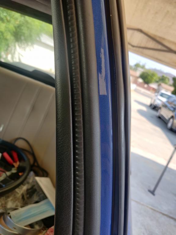

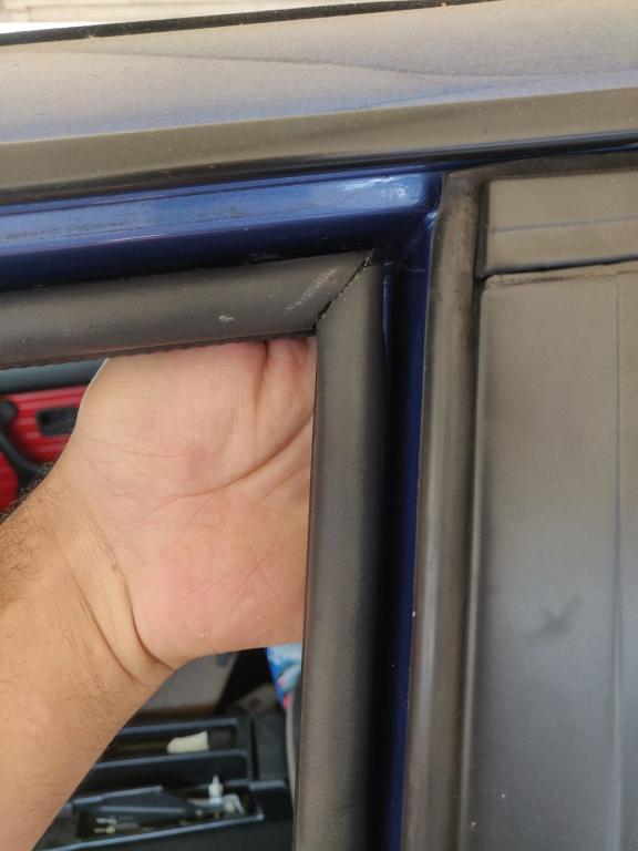

                    just a reminder buy the 20 ft because the 10 ft is obviously short !!
                    yes, I just took some photos, and let me know if you need more from a different angle!!
                    Click image for larger version  Name:	118302140_10222998534622694_1872129348831800532_o.jpg?_nc_cat=111&_nc_sid=0debeb&_nc_ohc=KCP69mJ0je0AX9F53pw&_nc_ht=scontent.fsan1-1.fna&oh=83e6cb6e007200c683d2a208c8db2318&oe=5F6C832B.jpg Views:	0 Size:	47.8 KB ID:	9947405
                    Click image for larger version  Name:	117967503_10222998536262735_503630156210469312_o.jpg?_nc_cat=107&_nc_sid=0debeb&_nc_ohc=mT21Dbg71I8AX9Hi_0d&_nc_ht=scontent.fsan1-2.fna&oh=2bb53f4a714a7e7c5867d27836546a36&oe=5F6CDEF2.jpg Views:	0 Size:	40.7 KB ID:	9947406

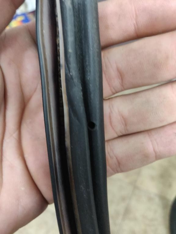

                    you will feel it is harder to close the door with this seal because it doesn't have holes like the OEM so you need to make some small holes on the aftermarket one to let the air pressure to escape. here is a photo of the OEM one that has holes
                    Click image for larger version  Name:	118280213_10222998582063880_6121372139870286490_o.jpg?_nc_cat=111&_nc_sid=0debeb&_nc_ohc=7VwkBKYNgMUAX-zT3p_&_nc_ht=scontent.fsan1-1.fna&oh=01a729bc4202aac26eca8c30520a6590&oe=5F6C62B7.jpg Views:	0 Size:	38.0 KB ID:	9947407

                        That seal material looks to fit really well and is the closest thing I have seen to an OEM alternative. You did a nice clean cut on the corner too BTW and good tip on the little holes to let the air out of the inner seal.
