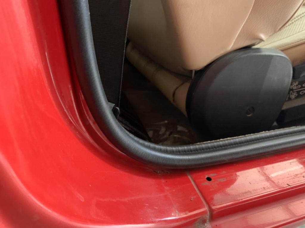

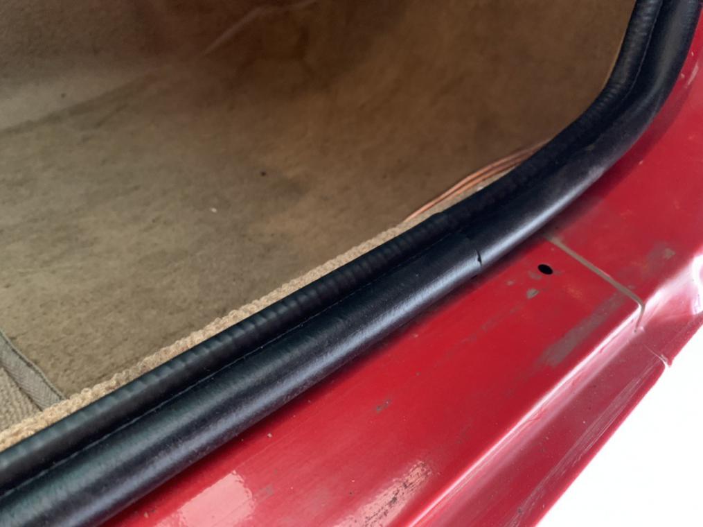

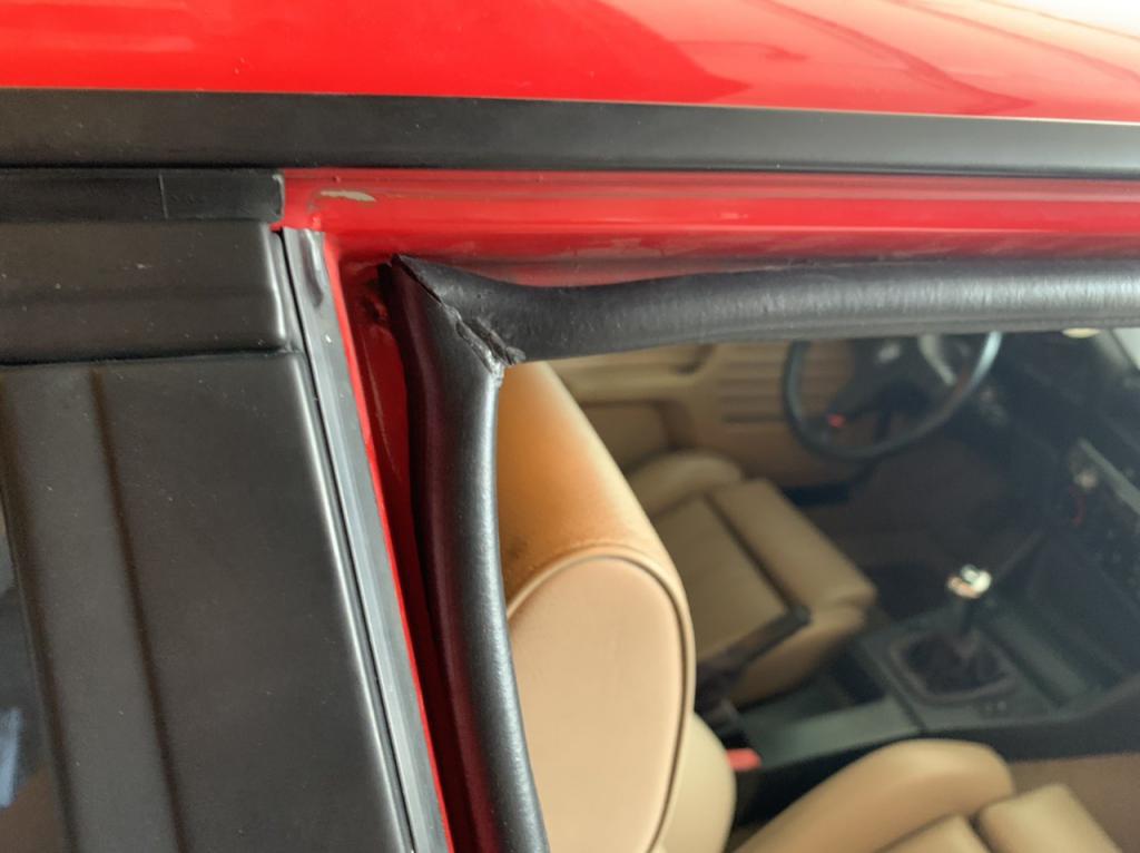

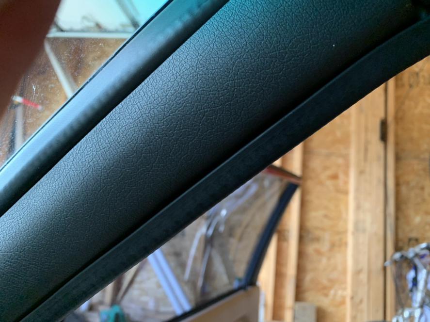

ID:	9922008 Click image for larger version
ID:	9922007 Click image for larger version
ID:	9922006 Click image for larger version
ID:	9922005 Click image for larger version
ID:	9922004 Got my Turkish seals today! Overall they aren’t bad at all. Negatives are that they are open ended. They’re sealed at the right angle corner, but then have a cut in them that I’ll have to seal myself. I’m assuming they did this so they could be less precise in the manufacturing. They did fit really nice though, and there’s more than enough left over to trim it precise. The corner that they sealed doesn’t look great, but I’ll use some good quality door seal glue and it should be fine. They also don’t have the little felt rim that’s on the OEM seals but this is pretty minor. It looks great on the interior, it matches up nice even without the felt. Overall I’m pretty happy. Pretty solid fix for a relatively cheap price

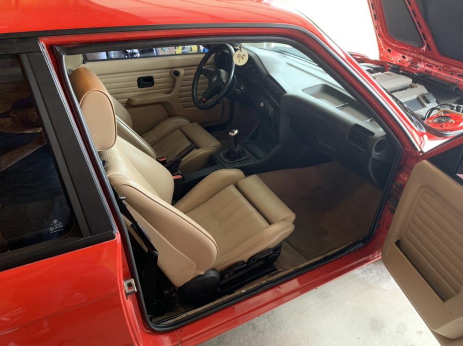

        Click image for larger version  Name:	70F9F80B-01AC-4512-9759-BCAC328A5512.jpeg Views:	0 Size:	62.7 KB ID:	9922013 Just trimmed it and it fits perfect. Door closes nicely, no issues. Just a tip: trim it a tad longer than you think, I thought I was going to have a bit leftover after the first cut but it ended up being perfect.

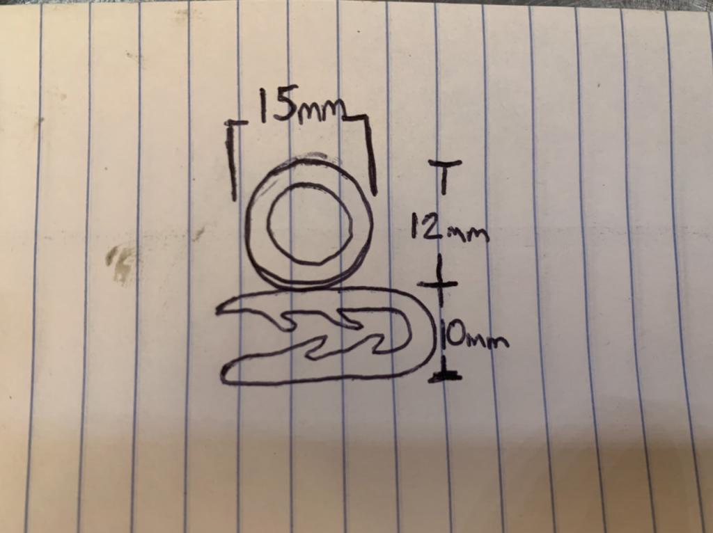

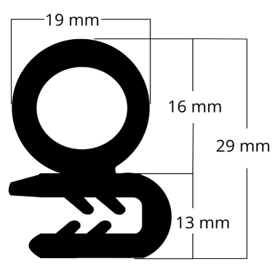

                    Kind of hard to get super accurate measurements, but this is what I just measured using vernier calipers on the “Turkish seals” I just received. Click image for larger version
                    All girls fuck but not all girls fuck around with combustion engines.
                      mamzak, thanks for this! So it looks like the bulk seal that usualdeviant linked to is a bit bigger, which it looks like in the pics.
                      But based on your measurements I think we can find a good match on McMaster.

                              Arrgh, with all this Covid craziness, I lost track of this. Anyway, I ordered some bulk seal from ebay, this stuff specifically;
                              https://www.ebay.com/itm/14-feet-Rub...72.m2749.l2649
                              Based on the measurements from mamzak its almost the exact same. However, it is obviously to small. I honestly think every deminsion of it is to small. THe gap for fitting it onto the body is extremely tight, so much so that where it also goes over the kick panel I could barely get it on. Then the seal part is way to small. With the door closed I can stick my finger between the door and seal and almost out of the car. Based on my car even the stuff usualdevient linked to seems a bit small, as its just under an 1/8th thicker.
                              next step is to try and find the best part of my stock seal that I took off, and try and measure that, add a bit and go from there I suppose.
