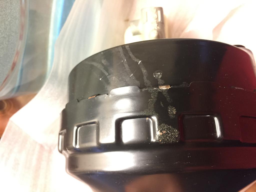

                        I got my booster couple days ago, and noticed this. Should i be concerned? It also looks like it was opened at some point because the little tabs that hold the halfs together seem to have the paint chipped off at the bend point. Tag says “ 06 330CI” what you guys think?
                          [ATTACH]122711[/ATTACH]
                          Hmmmm that does look strange. Use your discretion on it. If you don’t trust I then return it and get another one.
                            Sent from my iPhone using Tapatalk Pro
                            I’m thinking it might have sat in brake fluid from when it was removed and waiting on the shelf. When i got it it was covered in brake fluid, i’m going to try it and if it’s no good, i’ll just grab another one from ebay.
                              Ok cool.
