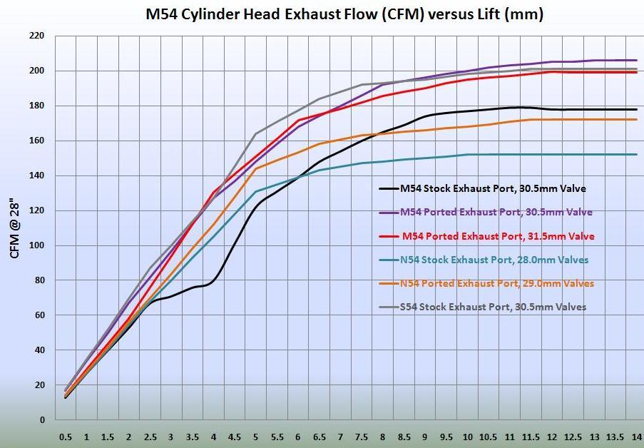

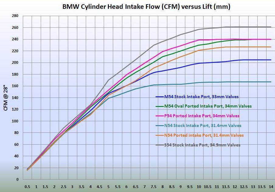

    any idea where to find this head flow comparison? I'd love to see where its most efficient airflow range is charted out-
    Found it.
    For anyone that isn't familiar with Adam, he goes by PEI330ci and has put a tremendous amount of effort (and money) into developing primarily the M54 but also other DOHC engines.
    These are his data:
    The original thread is http://www.bimmerboost.com/showthrea...ad-Development Lots of other good charts and data there.
