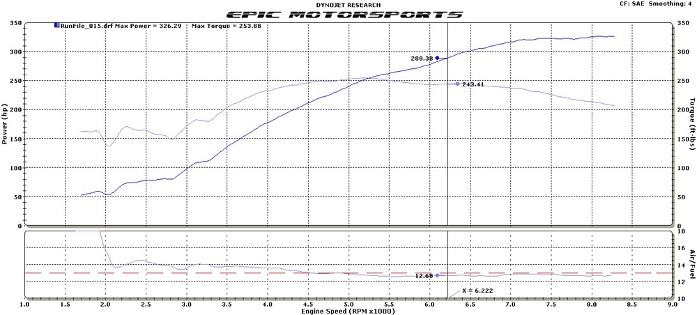

          However, here's a dyno of an E30 M3 with S54 swap running the factory MSS54 computer with vanos enabled, on an Epic Motorsports tune. Bone stock internals in the motor but it has intake/exhaust mods.
          The dyno numbers are lower than many I've seen with similar exhaust/intake mods, but the important take-away is the shape of the powerband. Holy flat torque, Batman!
          Vanos is good.

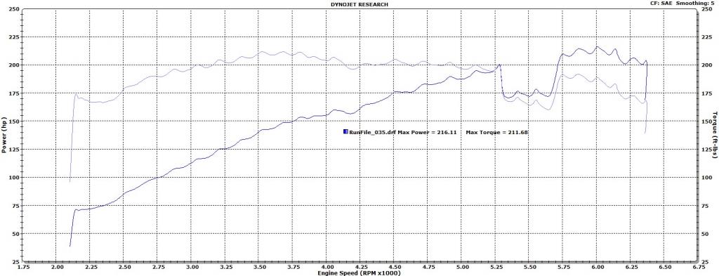

                    This plot is kind of interesting.. it was a mistake in programming one of my advance profiles on the intake cam. Intake cam went from full retard to full advance for a period of 500 rpms.
                    Kind of startled me and I didn't realize what happened until a few hours after the session. It's loud when it does that..
                    Plot shows that power instantly went down by 25 hp and 25 torques. It went back up 35hp!
