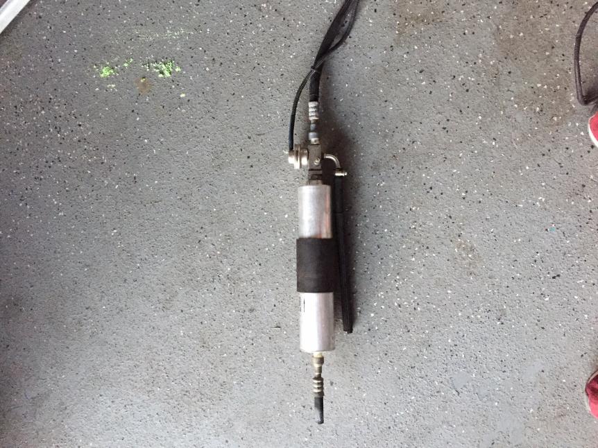

              #66
              Can anyone clearify on how to install the fuel filter and FRP, which is feed and which is return?
              E30love
              • Loupoz
                • Feb 2012
                • 166
                #67
                To hose pointing upwards is feed, the one pointing downwards with the filter is return.
                My 325I Mtech1 S54 Build
                • jink0619
                  • 808
                  #68
                  So the big line on the picture pointing up from FRP is feed line? and small line bottom of FRP which curls down is return?
                  E30love
                  • FredK
                    • 14761
                    #69
                    Yes, exactly.

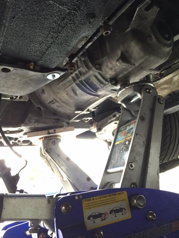

                            #73
                            Got the trans install on my back today! Hellyeah! but really it was not fun at all. Some may ask:why didn't u install trans attracted to motor? Well cause it wouldn't fit and I didn't want to disconnect the steering knuckle, so that's why! But with some help from two jacks I got it to mate on my first attemp :)
                            For the oil cooler, I'm gonna use my stock lines why? because I couldnt for my life get the lines off, so no fancy lines for me. I'm going to custom the stock lines with e46m3 fittings. Pics to come.
