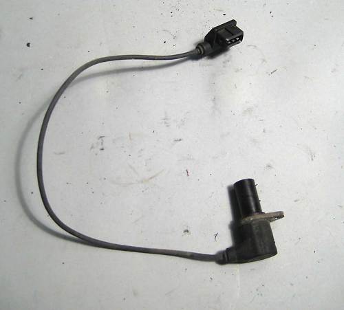

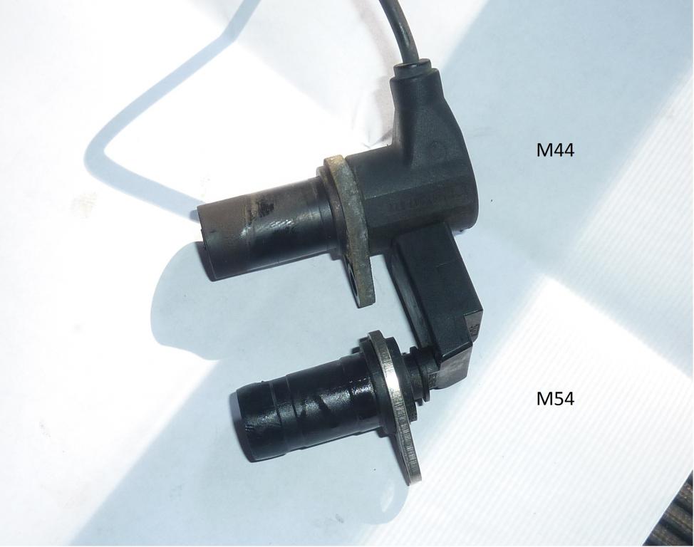

              Frank Ramos alerted me to the fact that the M44 crank sensor is a replacement for the M54 sensor, except that it is VR instead of Hall.
              This means a Hall conversion circuit is no longer necessary, I can get a native VR signal!
              The sensor is plug compatible with an M50 harness and fits the block perfectly. I'm guessing this is also the case with the M52 and S52.
              I've replaced my Hall sensor with the M44 VR one and the car runs. Only issue I am having so far is that the VR sensor generates very good voltage, but only tiny amounts of current. That little bit of current needs to satisfy both the 413 ECU and my VANOS ECU.
              The part number on the sensor is 12141247622
