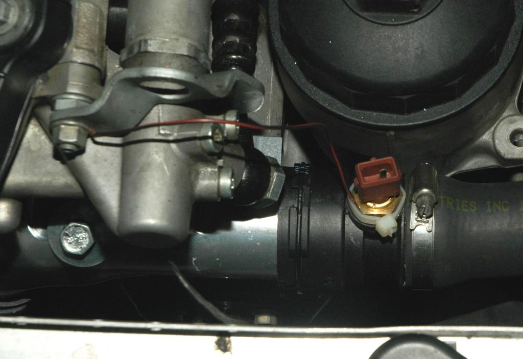

      Took it for a good 25 mile drive this morning and everything is working GREAT, except the $#@* temp gauge.
      I start trouble-shooting the wiring and get down to the ground path.
      Hello! It's a plastic fitting! Not a good conductor!
      I created a ground to the plug and now the temp guage works perfectly.
      I think I'll leave the zip tie like that, it goes well with driving around with the hood off.

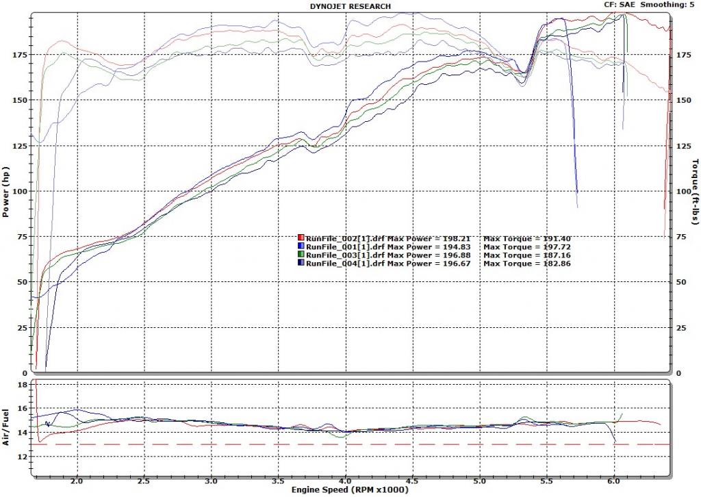

                        Dyno time
                        Dynojet. Stock e30 exhaust. DISA switches at 3800 rpm.
                        I'm making close to max torque at 1800rpm?
                        Who can read the graph and tell me when VANOS switches off. ha ha.

                          You're very lean, maybe dangerously so. Are you certain the wideband was calibrated properly? Could something else have thrown it off?
                              I think the wideband was accurate. It showed good richening at tip in and later he did some driveability checks and the A/F was more normal, although tending to lean.
                              I'm using the Dinan S50 chip. I don't know if the cam profile is causing it to go lean or the 8 extra degrees of VANOS advance. Fuel pressure is around 55 PSI. Should I bump up the pressure?
                              I think this was a good effort for a baseline pull. I need a better exhaust (the stuffing blew out after the first run. It was pretty funny!), I need to get my dual VANOS controller on track, and I need TRM to develop some pimpin' software for this. My goal is 220 wheel hp.

                                #120
                                I say more fuel pressure is in order
                                but the real culprit is the cam profiles, imo
