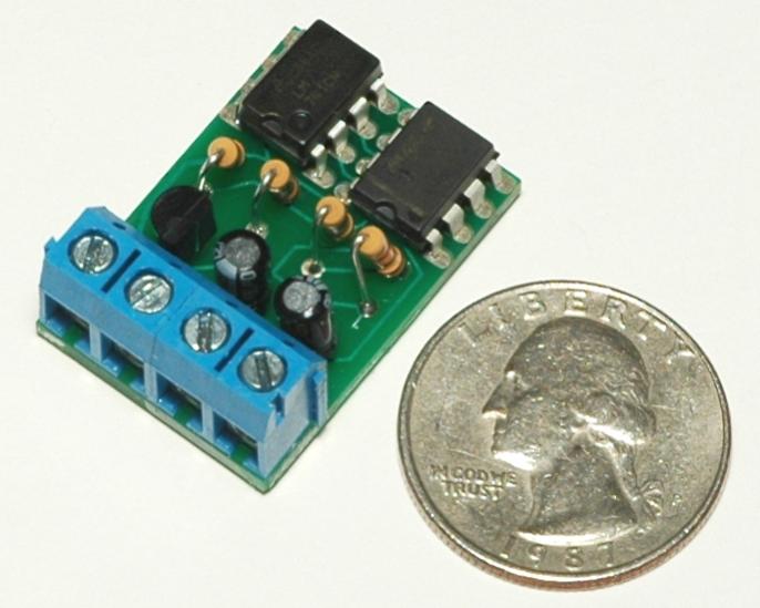

        BTW, I installed the final version of my Hall to VR conversion circuit today. Works titties!

              Steve loving your circuit - so simple and concise. Good work on that!

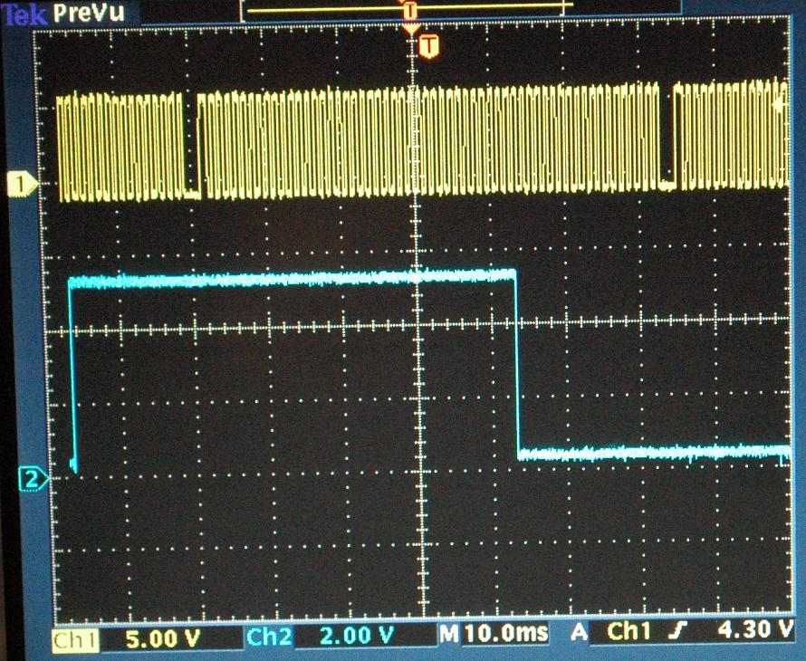

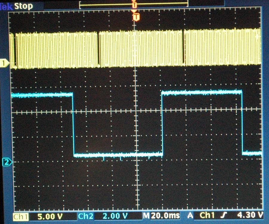

                  Love the O-silly scope!
                  I changed my software to average two cam signals and got the jitter out of the reading. It's rock steady at 250 degrees now.
                  That reading still seems kinda odd so I hooked the O-scope up to crank and cam signals simultaneously. The first picture clearly shows that the cam changes its state at right around 250 degrees of crank rotation. The cam wheel goes from the big part to small.
                  My LCD readout is dead on. Awesome!
                  The second picture shows why I was getting jitter when I read the pulses individually. The wheel isn't exactly in 180 sections. It's more like 174/184. At least that's how it's read. You can clearly see that one pulse is wider than the other. The LCD was constantly changing between 256 and 244 so that's why I couldn't read it.
                  Averaging is key otherwise the rapid changes would throw the Derivative part of my PID controller into chaos.
                  Also, VANOS retarded it reads 250. Advanced it reads 208. Do the math and you get 21 degrees of advance at the cam. Perfect!
