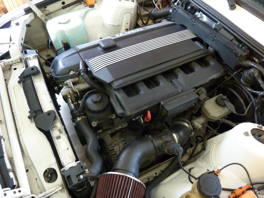

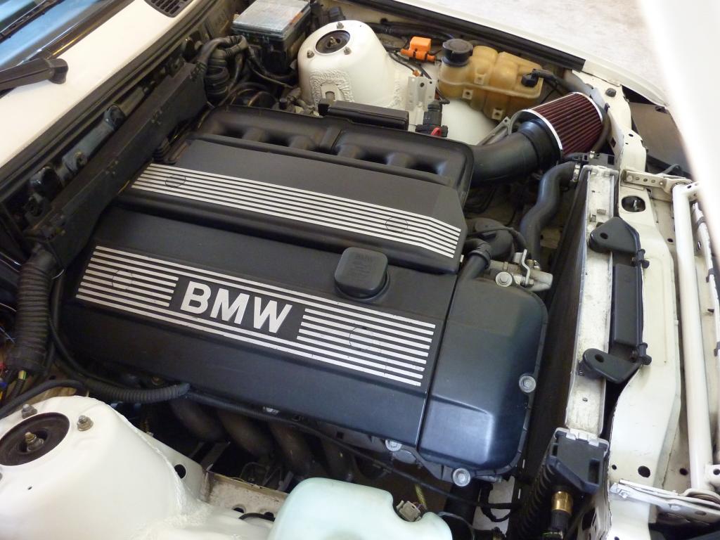

                    Gratuitous engine pictures
                    Engine bay is looking cleaner!

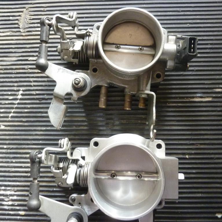

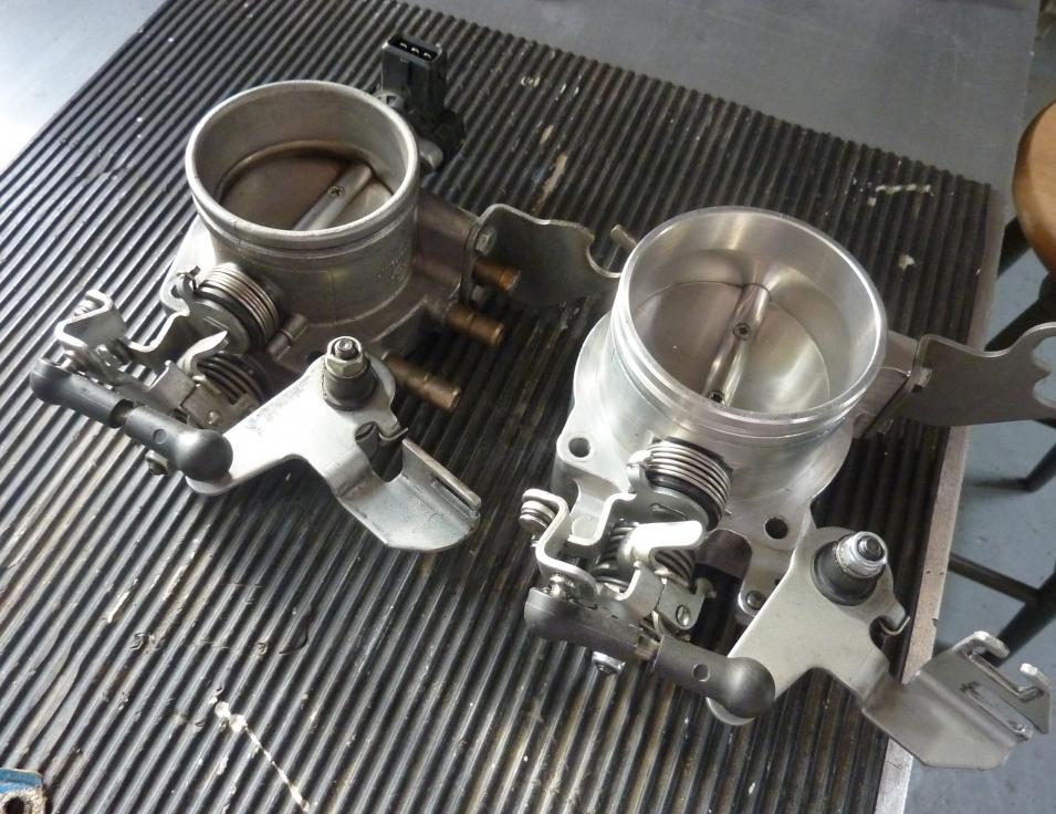

                            throttle body
                            So I've been working on the electronic throttle to get a permanent fix to my M50 throttle body. The electronic stuff was working great when Michael Hoy in Denmark mentioned that he could make a throttle body to fit the M54 that would use M50 components.
                            His work is superlative!
                            My inital reaction was the that the larger bore made the engine much more responsive, but I think that was due to a quicker increase in airflow at a given throttle position. After a day of driving I've adjusted to how the throttle responds more quickly, but I'm convinced that the motor pulls harder.
                            My theory is that BMW probably tried a larger TB on the S50 but decided that 4 or 5 extra hp wasn't worth the trouble of manufacturing a new unit so they stuck with their existing parts bin. They went larger on all subsequent 3.0 litre engines including the M54. I think all S50s should have one!

                              #299
                              How much did that run you?
                              • Danny
                                • 14216
                                #300
                                Is it just bolt on to the s50, steve?
