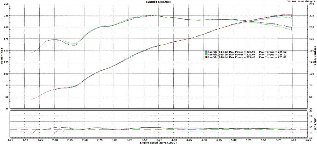

                      #385
                      227whp on Megasquirt!
                      I forgot to turn off fuel cut at 6000 or I'm sure it would have crossed 230whp at 6200. Oh well...
                      I have more details on the M54 megasquirt blog http://www.m54megasquirt3.blogspot.com

                        #386
                        When did you convert to Megasquirt?
                        • hoveringuy
                          • Dec 2005
                          • 2753
                          #387
                          I started in November. I used an adapter so I could plug it into the stock harness just like the stock ECU so I could easily switch back if I needed the car to run like stock. It took me a month to get most of the starting/wiring/tuning issues cleared-up and I've been daily-driving it all year.
                          I never had the need to switch back...
                          It's gotten to the point where I forget that I have Megasquirt. It starts in the morning, idles smoothly and pulls strong. As a bonus, I don't have to bump the idle up to 900 rpms for my lightweight flywheel. It idles nicely at 750 and never stalls.
                          Plus I have traction control!
                          All that, and it makes more power than the 413 ever did!
