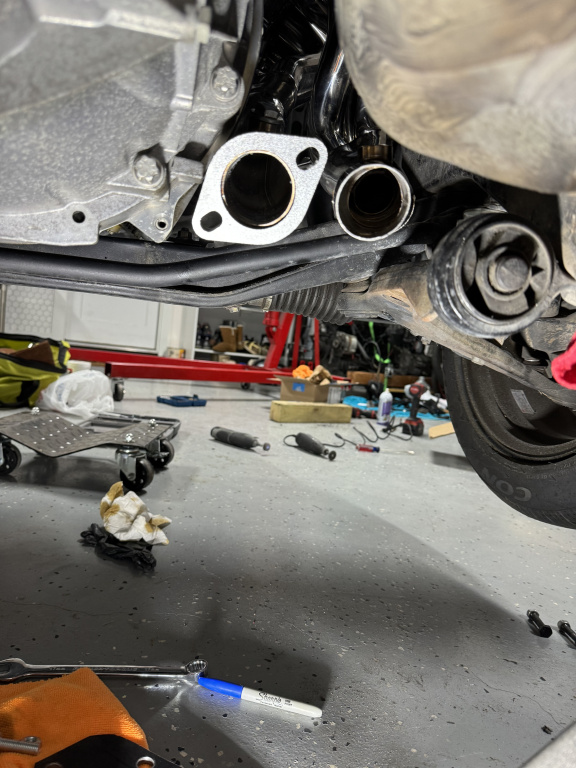

    These header flanges point down way too far for my taste, they could also be much closer to the transmission. I cut the flange off the rear set so I could actually get them mounted flush on the head. I think the only work required will be behind the collectors. My plan is to get the front set turned towards the rear of the car and moved up and in closer to the transmission then pull the engine to get the rear set matched as close as possible to the front. I want both flanges above the CAB.

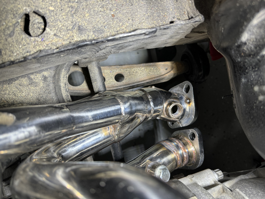

    Lots of clearance between the frame rail and headers, about 1/2 between the headers and sway bar.
    This flange is too low and pointed down too far.

        Did some more work on the headers. The front set was just a couple cuts and took a couple inches length out.

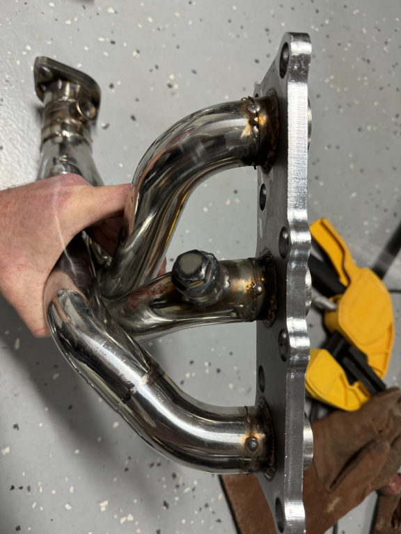

        Rear set took a few hours of messing with it in the garage. Multiple cuts, tacks, and re-cuts but I think I have them sorted.
        Once I had it close to where I think it will work, I drilled a scrap piece of thick sheet metal to mount on the other flange. Clamped the flange to it and tacked it together.

        I have no idea how that weird bend after the collector will affect performance but they fit now.

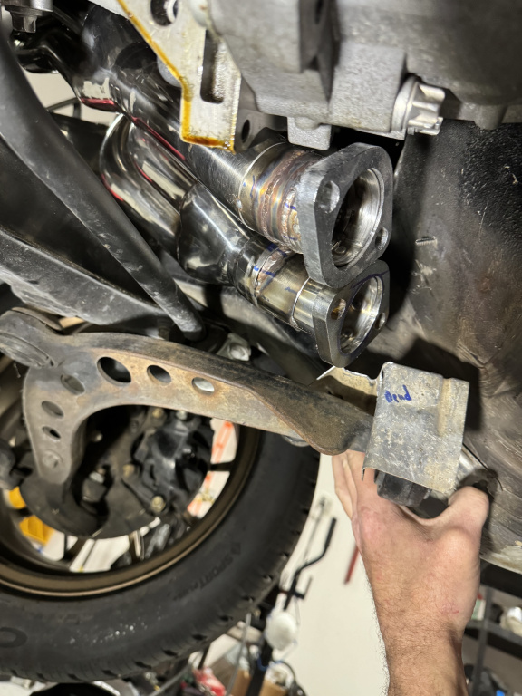

                      So I tried to mock up the exhaust with the wrong engine mounts. My engine was about an inch closer to the driver side frame rail, didn't realize until I tried to fit the intake with the bosch ibooster installed. Lesson learned, Revshift 24 mounts will not work. I got the AKG ones and now that the engine is centered one of the flanges is closer to the CAB than I would prefer. I cut the rear header primaries just past the flange and shortened until the rear set just cleared the front set.
                      It got rid of the weird bend in the rear set and I tucked the front one a little closer to the transmission.

                      I should even be able to use the stock heatshield with just a minor modification.
