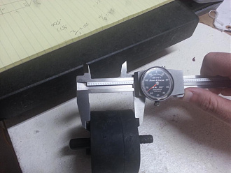

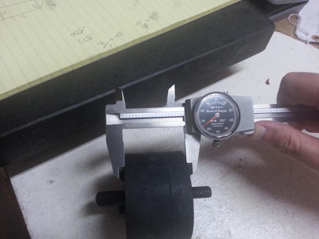

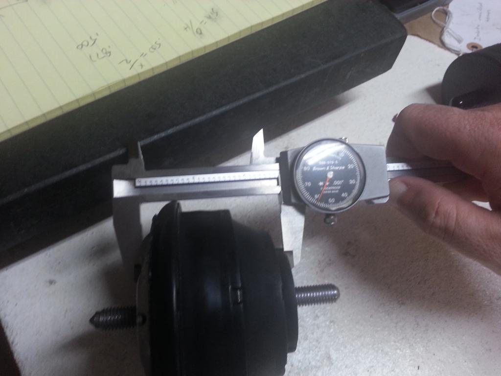

                            I made some discoveries in the last week or so. One thing I'd like to mention is the height difference between the stock E30 M20 (47.5mm) engine mount and the Z4 E85 (67.5mm) engine mount.
                            The Z4 mount is 20mm taller than the E30 mount. Sorry about the reflection off of my calipers.
                            Click image for larger version  Name:	20200801_211802.jpg Views:	0 Size:	58.1 KB ID:	9942669 Click image for larger version  Name:	20200801_211824.jpg Views:	0 Size:	64.3 KB ID:	9942670 Click image for larger version  Name:	20200801_212417.jpg Views:	0 Size:	67.9 KB ID:	9942671 Click image for larger version  Name:	20200801_212457.jpg Views:	0 Size:	60.8 KB ID:	9942672 Click image for larger version  Name:	20200801_212441.jpg Views:	0 Size:	56.3 KB ID:	9942673

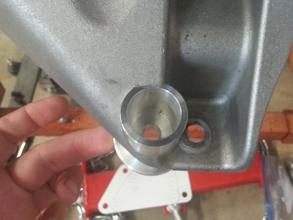

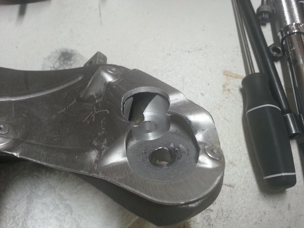

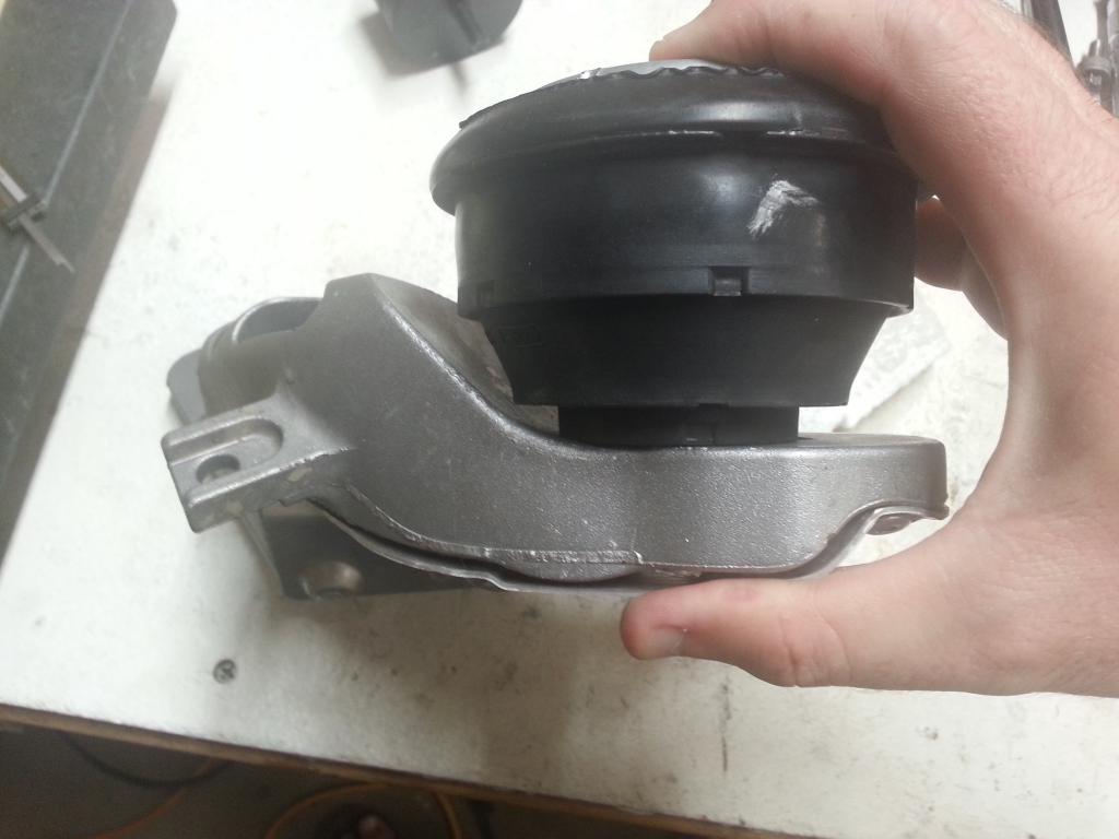

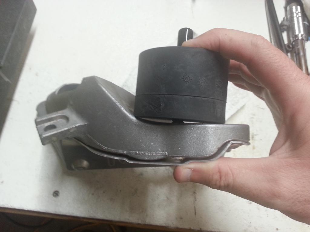

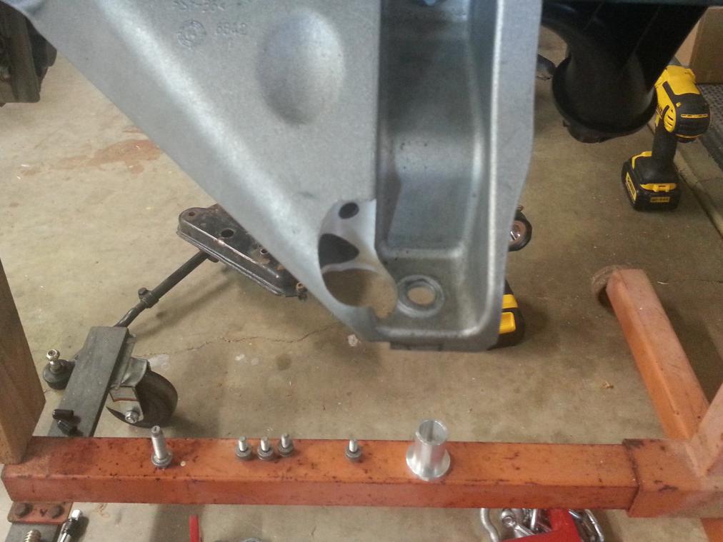

                            I was also able to get into the machine shop for a bit and I machined the right side E85 mount arm. Once that was done, I could test fit the two different mounts. It turned out that the E30 mount that I planned to use is too large in diameter to fit down flush against the mount arm. The E85 mount fits fine, but then there's the 20mm change in height towards the hood.... It looked like the Garagistic 80A mounts were smaller in diameter, so I'll find out later in the week. I could probably machine the E30 or 80A mounts to fit, but it would be better if it didn't need it.

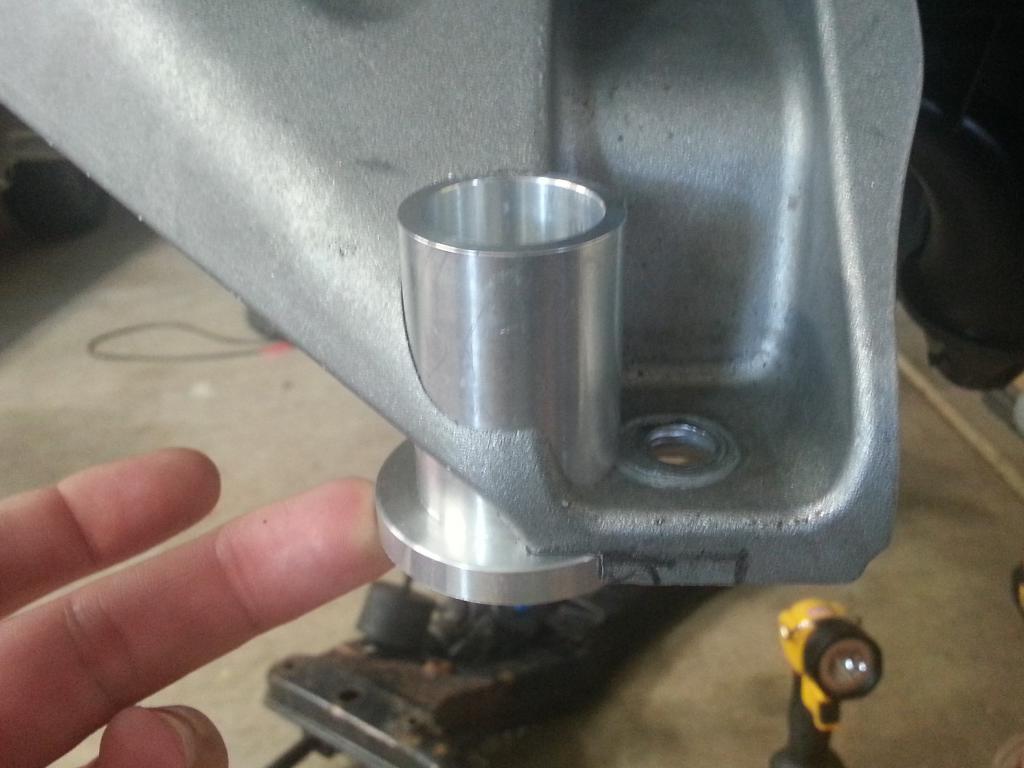

                              I was also able to machine the left side E85 mount arm. I haven't had the parts welded yet. Here's what I'm trying to do.
                              Click image for larger version  Name:	20200803_151308 (2).jpg Views:	0 Size:	80.2 KB ID:	9942685 Click image for larger version  Name:	20200803_151329 (2).jpg Views:	0 Size:	71.5 KB ID:	9942686 Click image for larger version  Name:	20200803_151335 (2).jpg Views:	0 Size:	78.3 KB ID:	9942687
                              • nando
                                • 34844
                                #285
                                That's a cool idea. Surely, easier than fabbing an entire mount! But it does require you have a machine shop and some skill. :p
