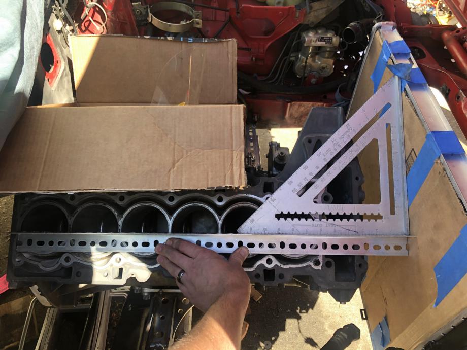

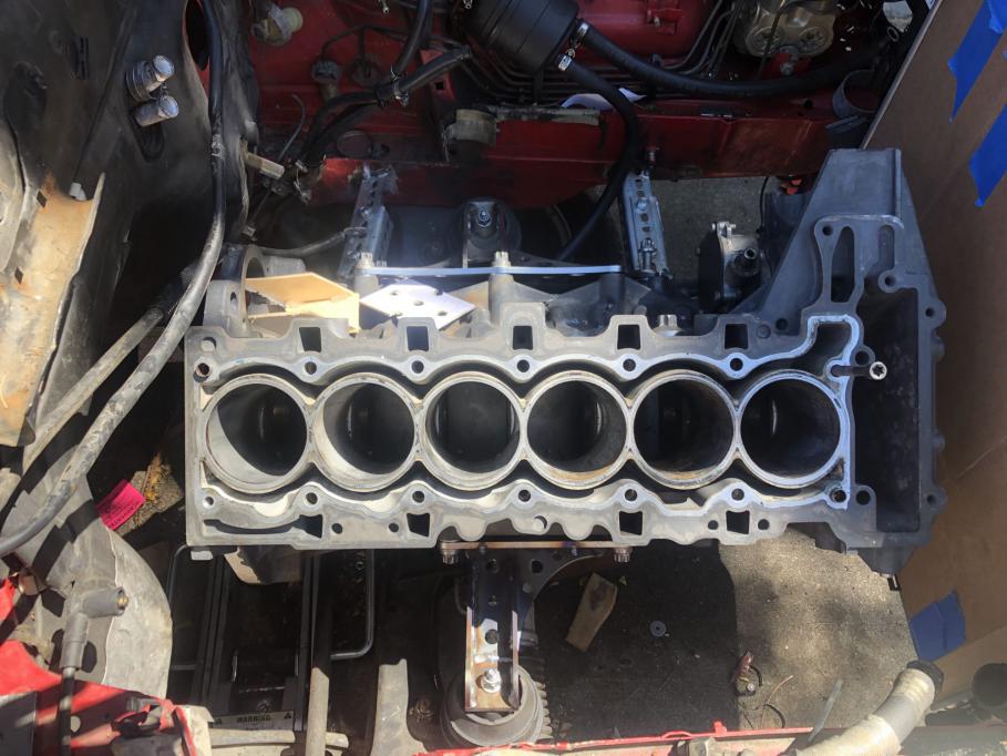

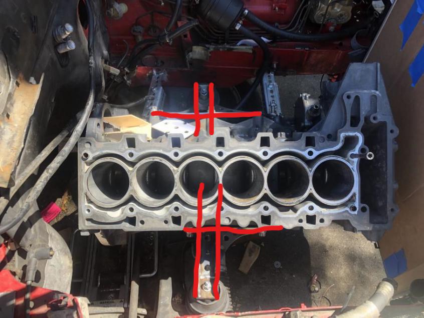

        If you look at your picture of the 'bore sighted' engine block..... And look at the concentricity of the main caps...
        It looks to me like the front of your engine is 'tilted' toward the right side of the car. If you move the front of the motor to the left, using the right side mount as a pivot point, you may get closer to that " alleged one inch " dimension on your left side mount.
        You may be in the right spot, it just may be that the crankshaft is not parallel to the frame rails.

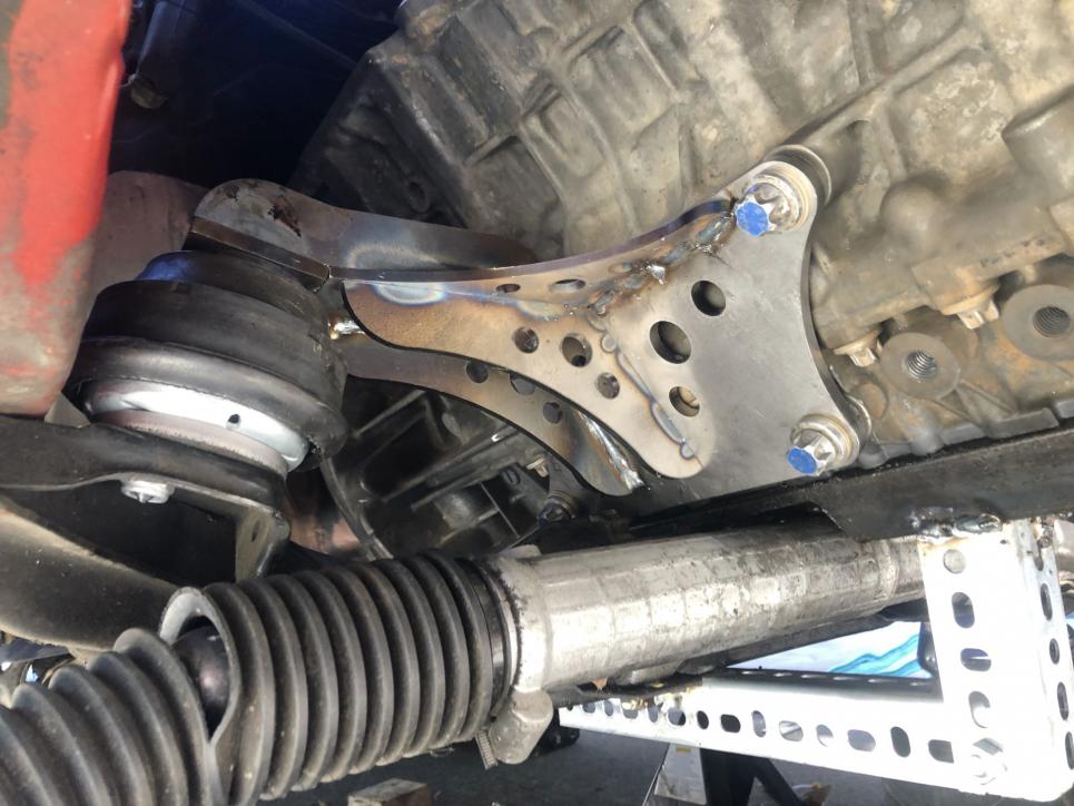

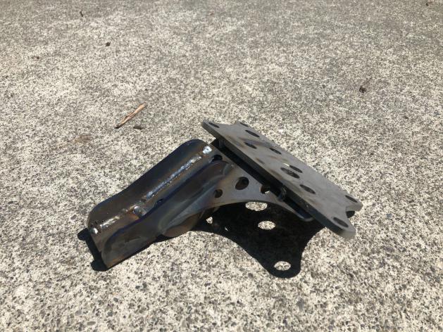

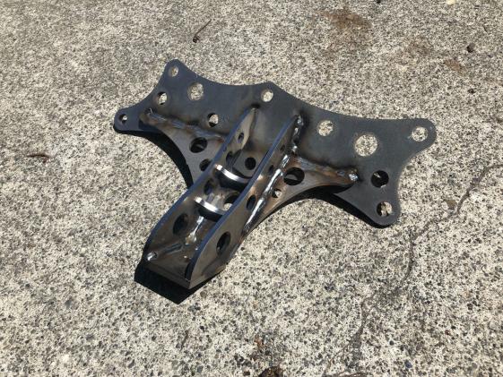

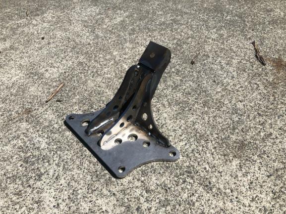

          I picked up engine arm Rev 1 pieces on Thursday. The plates against the block and against the motor mount are 1/4", the rest of the webs and gussets are 3/16. I'm going to start with the starboard side because it went perfectly (ominous). I fitted the upper stiffeners to the motor mount plate and the web and tacked them in place, set the plate on the motor mount and rotated the web until it made continuous contact with the plate on the engine, tacked that, and then fitted the lower stiffeners. Here it is from the above-front:
          This is from the front, but the underside:
          and this is the bracket in place after going back and filleting one side:
          Basically no complaints about this side. I didn't have the relationship between the upper and lower stiffener established (because it depended on the thickness of the material) but now I can trace one side of this and the upper and lower stiffeners can "slot into" the web. There's no great way of locating this perfectly on the engine plate at the weird angle, but I have a spare engine plate and motor mount plate to create a fixture for this so it can be recreated if we need to without disassembling my car.
          The port side went almost as well. Almost. I was a little too attached to the arm being the same width as the motor mount plate:
          Similar to the other side, the motor mount side is pretty nailed down geometry. The vertical webs match up to the motor mount plate, and the flat web matches up with the corner. I'd kinda figured that this was going to be close, but it ended up being some grinding to clear the bolt. To actually be able to feed the bolt? Might not be possible. Luckily my brother was here and asked me why I hadn't made it wider. duuuuuuh. There was also some grinding to get the vertical webs pulled back a little so the flat web was touching. I didn't quite get that right. Both easily fixable, and this'll do for now. After easing back those two areas I dropped the web against the engine plate and tacked it in place, then pulled it off and filleted one side:

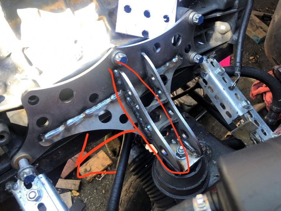

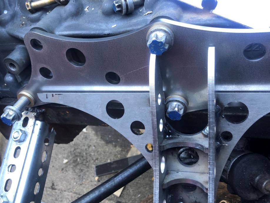

            Here's that bracket bolted back in place:
            The red squiggle is the vertical web that needs to come over. This just means my square plate on the motor mount becomes a little rectangle. Super easy to move that over 3/4" and have tons of room. I don't have enough bolts for all the holes right now anyway (since I now have six on this side) and the one in the bottom left needs to be cleaned with a tap before it'll go in any further on either block.
            Here's how they relate to each other. This photo isn't particularly aligned with anything, and the shadows and fillets make everything look weird, but pulling a line across the image is looks like the rear side of the arms aligns pretty cleanly (which they should)

            LukeJ once again has me on my toes more than the rest of you... so everyone else better catch up looking for mistakes. the boresighting is... yea. super rough. I don't think the output shaft of the trans is aligned with the crankshaft anyway, so there's going to be an offset. I thought it was a cool shot and was reality-checking the declination angle.
            I *don't* and *didn't* have a great way of nailing down alignment with the chassis... the chassis rails taper inwards here, so centered between them is meaningful, but they're not useful for much else. The alignment was done with the transmission attached, and centering the shifter in the tunnel port, So my control is that the shifter is centered and the e90 motor mounts holes were equal distance to the frame rails on each side (each of these probably to about 1/8"). I still don't have a great check for this not being skewed in the car because the block is leaned over, but here's a straight edge along the bores with a speed square against the radiator:
            The radiator here was pushed up tight against the firewall and the speed square is just nudging it.

              I wasn't pointing out a 'mistake' as much as giving a possible reason why your 'otherwise good' engine placement still doesn't completely jive with other documented instances.

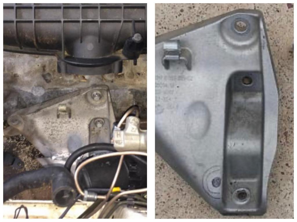

              If the motor was pivoted, then the bolt would be more in the center of your left mount arm Click image for larger version

                    As far as measurement goes.
                    Are you able to measure from the back of the block to the subframe on both sides?
                    I'd think having the block square to the subframe would be better than square to the radiator.

                      This is what I see when I look at this picture. Click image for larger version
ID:	9940982 Sorry I wasn't able to freehand the lines straighter.
