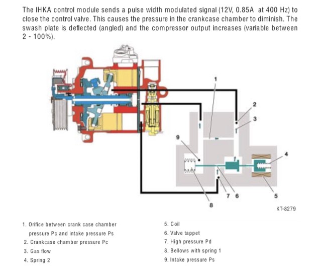

      This is a different model, but still a BMW PWM compressor. I expect this is going to be the same frequency and voltage.

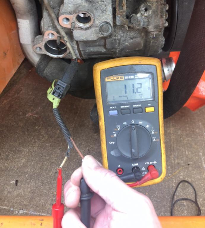

          So. Last post about AC until the engines turning. I promise. I know no ones else cares about it ;)
          I’m just trying to determine if I can talk to the compressor without some serial connection I don’t understand. The alternator reports back to the DME in a language I don’t talk.
          If we assume that other reference is consistent with how PWM controlled variable rate compressors work (and other compressors on other manufacturera cars seem to work the same way) we can start figuring it out. As long as those wires connect to a coil and not some computerized controller, the resistance between them is meaningful.
          The info we have from the 7 series documentation above is 12v, 0.85A, 400 Hz. The frequency is almost meaningless. A coil doesn’t care if it’s driven by 400 or 600... but we can consider 400 a minimum (if it was 25 we’d be shaking the compressor to pieces, but at 400 it smooths out.)
          PWM is just a stand-in for variable voltage on a motor controller like this. If your supply is 12v and you turn it on and off 400 times a second with equal durations, a DC motor just thinks it’s being driven by 6v. If you turn it on and off 400 times a second with the duration 2/3 on 1/3 off, it sees the equivalent of 9v.
          If the coil was expecting to see 12v PWM with 99% on, 1% off and drew 0.85A, we’d expect its resistance to be around 14 Ohms. Well... it’s 11.2. By my monkey math that means we can certainly safely drive it with a constant 9.5V, or 66% duty cycle on the PWM driver. (I put 1.5v across it and didn’t hear it move).
          I’m going to pursue powering the compressor from the e30 chassis wiring, and controlling the demand with the PWM. I’m concerned that the DME control of the AC relies on other safeguards such as temperature sensors in the e90 dash HVAC (to prevent the evaporator icing up).

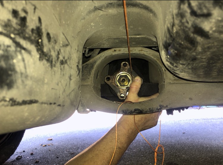

            I wasn't able to see your alignment picture either. I have no idea 'where it ended up'. Was your block tilted, or did you already have it lined up?

              Oh that’s suspenseful... they’re showing up for me so I didn’t know what the issue was. Here’s where crank centerline hits... our conclusion was that we’re about 1/4” off chassis centerline at the rear axle, but the engine wiggles enough on the mounts to make that negligible. It’s a big ratio between the width of the engine and the distance to the rear axle... this misalignment is 32nds of an inch at the front. I could cut and re-weld the arms and be wrong in the other direction by twice as much.
              The diff is offset from centerline by about 5/8" to starboard, so as the engine sat in my fixture, we were slightly more offset than factory... but over the roughly 36" between the U joints it's the difference between 1 degree of joint angle (factory) and maybe 1.25 degrees (current fixture alignment).
              Click image for larger version  Name:	A6518979-DC12-4F7E-BDBB-F93F5E1B27DB.jpeg Views:	0 Size:	97.1 KB ID:	9941416
              Edit for clarity: At the rear subframe, the string is about 1/4" to port, that is the engine is pointed very slightly towards the left rear wheel. Over a 101.2" wheelbase this is a misalignment of less than a half degree.
              The diff is offset to starboard (left in this photo, but right in the car)
