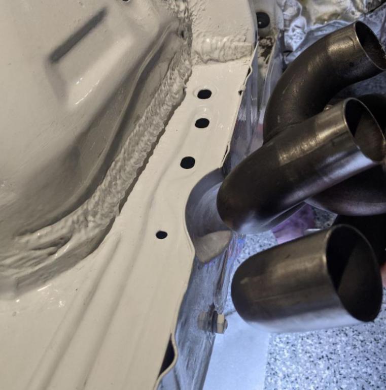

    Are you sure your exhaust won't clear? I checked mine and it's fine. In fact, there's a perfect recess seemingly exactly for the #2 runner.
    Maybe it's because I have a facelift car?

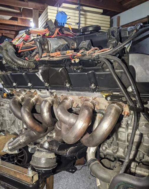

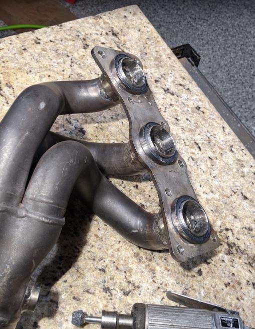

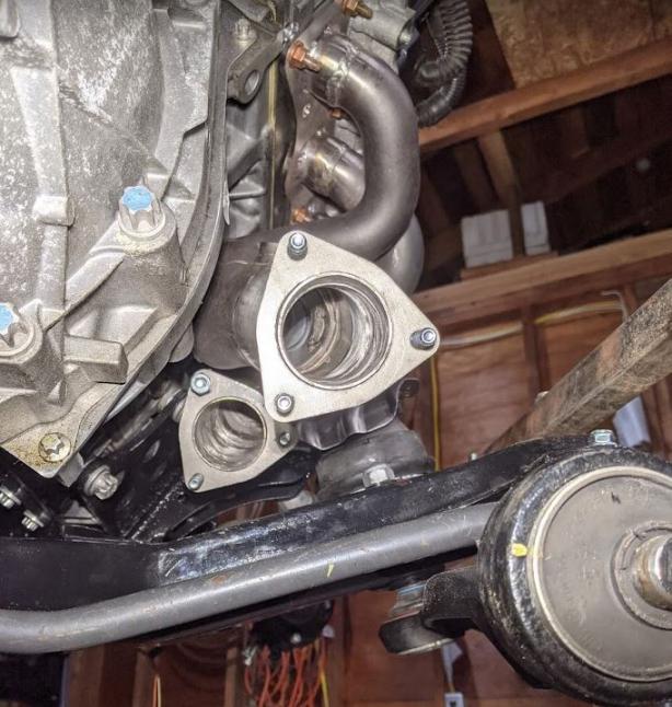

      Exhaust update. My headers are almost done, just need to weld the 3-bolt flanges on when I get the secondary done.
      No V-bands for me, at least not here. I've always felt that the OBD2 flanges were super-easy to remove and install. V-bands can be king\d of a wrestling match when I've needed to line-up 2 at once.
      The reducer isn't just a cone, but has an S-shape. These were fully back-purged, the only place I got sugaring was my tacks.
        *snip*
        It looks well done by some PO, but not factory? My 91 318is doesnt have this notch. Anyone else?
          Absolutely loving the progress on this, you guys. Its the perfect motor for a 318is :)
          Peter
          I'll fess-up. I did it.

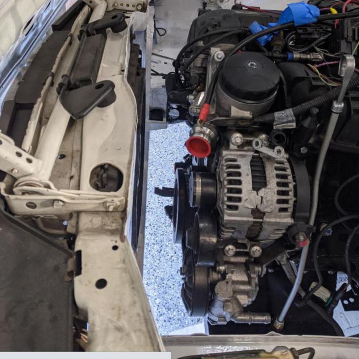

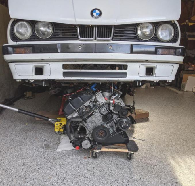

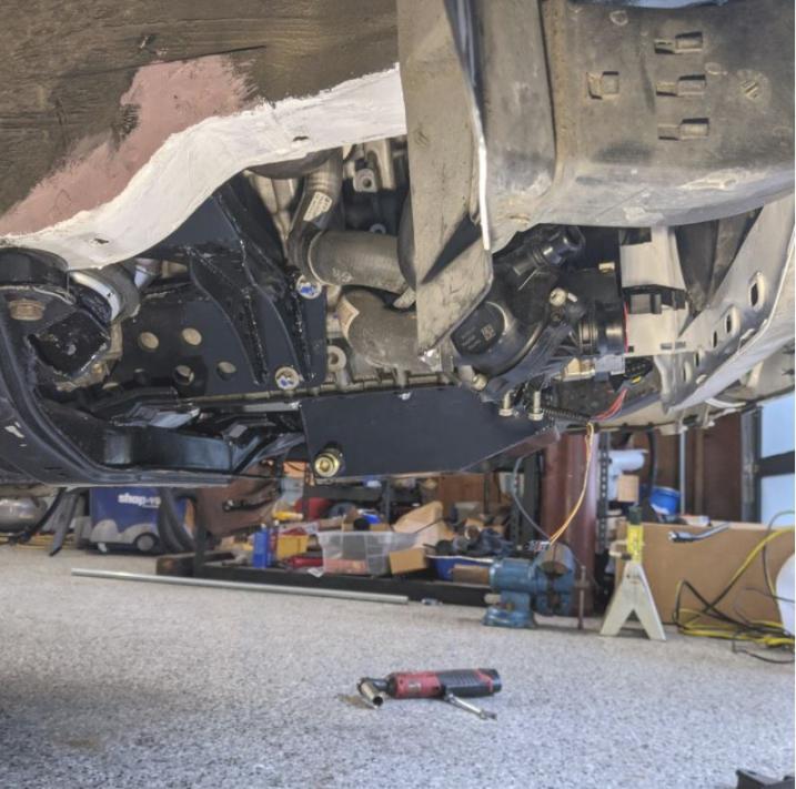

              Yes, I ran out of things to do with the engine hanging from my rafters so I took an hour to install it. Super easy.
              The headers clear everything just fine and I probably would have had 1/4" of clearance between #2 and the frame rail even without the relief, but it sure looks cool. I went with 3-bolt flanges instead of V-band and those are nicely accessible. Miles of clearance to the CAB, subframe and sway bar, like OEM.
              Click image for larger version  Name:	Capture.JPG Views:	0 Size:	67.9 KB ID:	9967215 Click image for larger version  Name:	Capture2.JPG Views:	0 Size:	70.6 KB ID:	9967218 Click image for larger version  Name:	Capture3JPG.JPG Views:	0 Size:	75.8 KB ID:	9967216 Click image for larger version  Name:	Capture4.JPG Views:	0 Size:	52.0 KB ID:	9967217

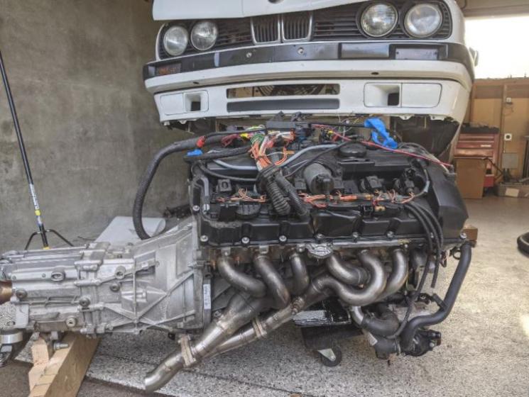

                It all fits.
                The oil pan is very svelte and is equal in height to the subframe, plus with the bevel it probably has more clearance than an original M20. Plus, being fabricated from 14Ga steel it can probably do double-duty as a skid plate.

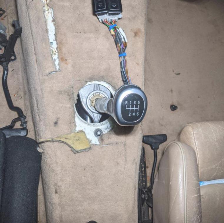

                The shifter is nicely centered, like it was engineered to be that way.
                The engine is centered in the bay and lines-up longitudinally with the center of the car.

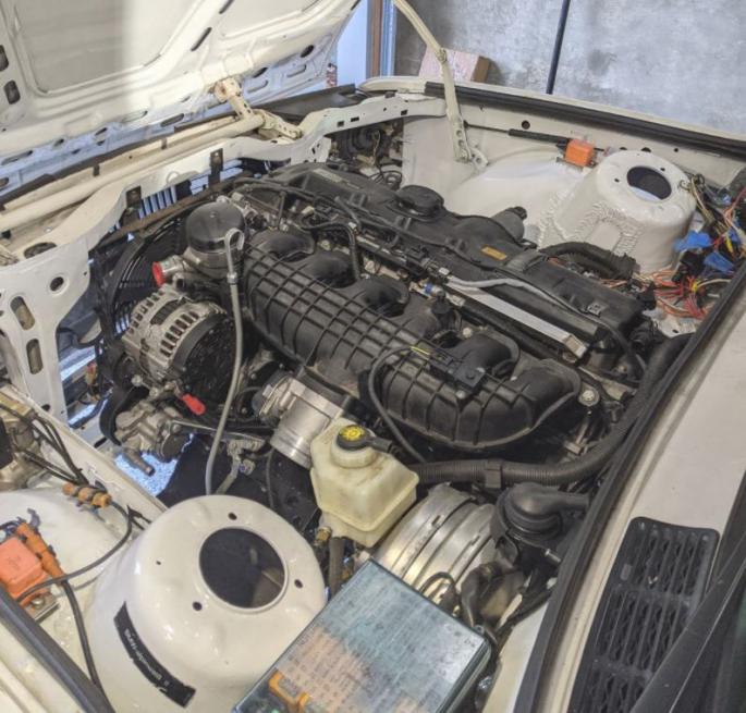

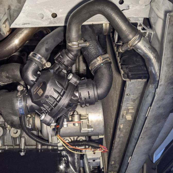

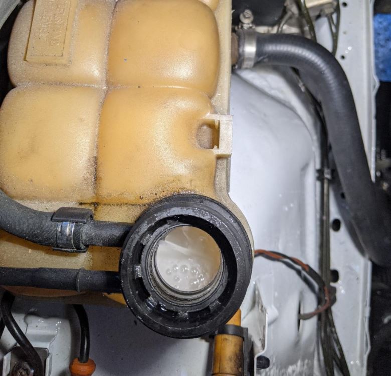

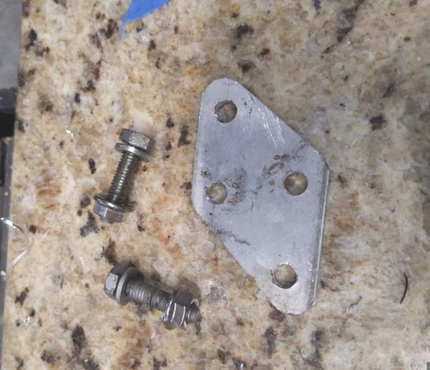

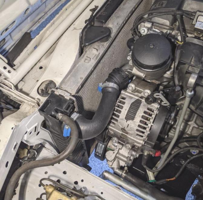

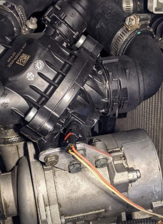

                        My task an purpose this week has been to complete the cooling system and get enough of the exhaust done so that I could let the car idle.
                        The first challenge was the hose from the radiator to the thermostat inlet. It's tight, and the hose was initially riding on the radiator with a kink in the bend.
                        Fortunately, the thermostat is bolted to the water pump and can easily be moved back so I did that. An aluminum adapter plate, the holes are 25mm on-center and I moved them at a 30degree angle for 30mm. The math inclined will calculate that it results in an extra 15mm of clearance.
                        Lots of clearance everywhere now. Sorted.

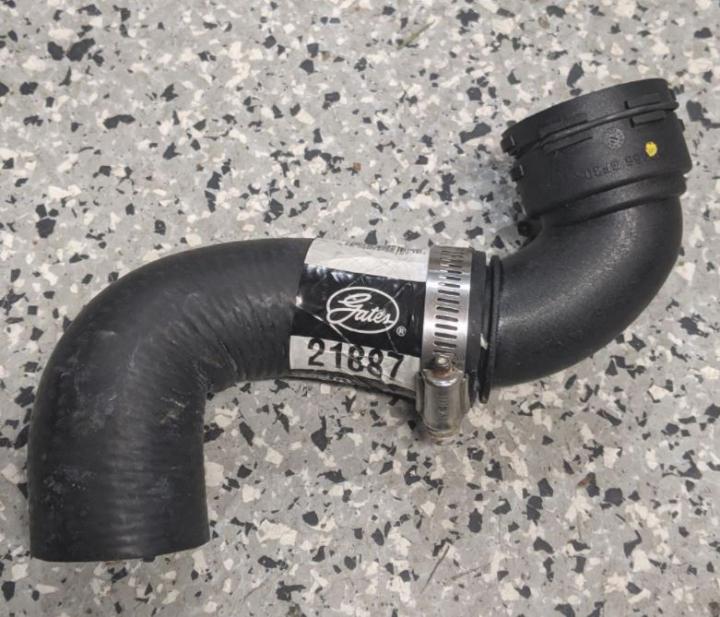

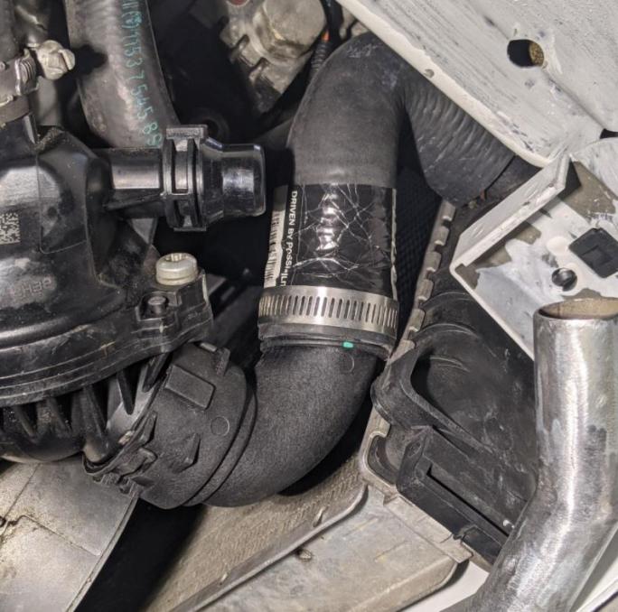

                          The lower radiator hose ended up being a Gates 21887 hose matched with the 90 degree fitting that normally connects to the E90 radiator, except it now connects to the thermostat. The indexing tabs on the thermostat need to be removed so that the 90 can rotate.
                          There are two versions of the 90; some have the fitting for the radiator outlet temperature sensor, which is used by the DME to control the aux fan. I use the e30 dual-temperature switch in the stock radiator, so no temp sensor here.
                          What does the Gates 21887 normally fit? It's the lower radiator hose for an E30 with M20. A sign from the Gods! *Update* The M20 upper radiator hose, Gates 21886, actually has a tighter 90 and can be cut to fit. Both work, I think the 21886 works better.
                          Click image for larger version  Name:	Capture.JPG Views:	0 Size:	74.4 KB ID:	9968450
                          The sharp-eyed may have seen the cross-under tube in the post above and thought I grabbed some conduit I had laying around to fabricate my cooling system. Nothing could be further from the truth, it wasn't laying around- I had to go out and buy it.
                          it's a prototype to see how it works, the final one will be some kind of bent 7/8 stainless pipe. It replaces the plastic piece found on E90's that won't fit the E30. It's meant to connect both the cooling reservoir* and heater core return to the thermostat.
                          Works just fine so far. Routing is tidy. Next...
                          Click image for larger version  Name:	Capture2.JPG Views:	0 Size:	73.4 KB ID:	9968449
                          * I'm running the stock e30 reservoir, but there's no reason that it couldn't be on the passenger side. The cross-over would still be needed for heater core return.

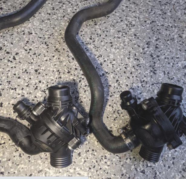

                            There are two versions of the thermostat. The X5 and most others. They both work fine, but the X5 one (left) has a 90 in the outlet that results in more direct and cleaner hose routing.
                            Click image for larger version  Name:	Capture.JPG Views:	0 Size:	77.1 KB ID:	9968455
                            The upper hose is presently a 45 degree fitting and an E30 upper hose. Not difficult.
                            Missing from this picture are two things 1) the e30 cluster temp sender and 2) a 3/4 nipple on the hose that feeds the heater core.
                            My plan is to use an M54 straight fitting with the temp sender taken off the lower radiator hose of an M54. That's where the e30 temp sender will live in place of the 45 fitting.
                            There are off-the-shelf radiator hose adapters that that will give me the 3/4 hose fitting, but I plan to fabricate a stainless 90 at the rad inlet that will allow a tighter 90 required to have the straight fitting on the engine, and that will have the 3/4 hose drop straight down next to the radiator end cap.
                            Click image for larger version  Name:	Capture2.JPG Views:	0 Size:	75.4 KB ID:	9968454
