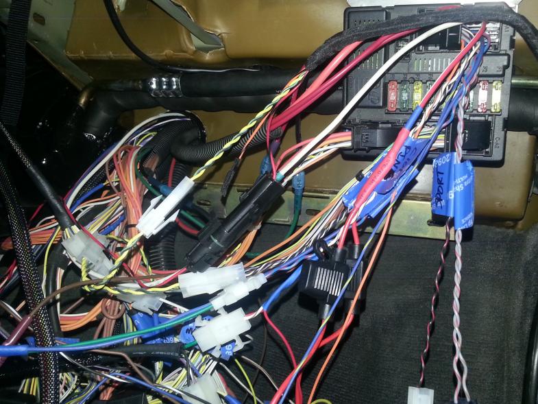

      I may have bought an X3 harness at one point but honestly forget how long it was, it's probably somewhere in my posts. The X3 and 330 versions of the harnesses use kinda rats-nest of plugs and relays. On those cars, they live in the big plastic ECU box and there's a place for them. On the e30 not so much, unless you want a big rats-nest of stuff. I highly recommend that you get the IVM module. It integrates all of the body to engine wiring, contains the relays and such in one svelte little box that sits in the glove box.
      I may have even used the X3 ign wiring and just cut it to fit. It's pretty easy to re-pin the wires to go in the modular plugs. There are ZERO relays in any of my wiring between the IVM or ECU and the engine.

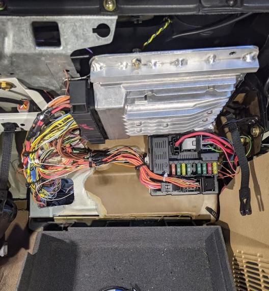

          The IVM is huge, it's incredibly nice to condense all that crap into one little box. Do you have the wiring guide that hubcapboy put together?
          I put the EKP in the right rear door panel near the pump. The only wired that run to it are a wake up signal (ignition) and twisted pair for CAN. This keeps the actual power routing shortest and it's one less box up front

              My wiring looks like this, e36 will be different, of course. You may even have a place in the cowl for all that stuff. Click image for larger version

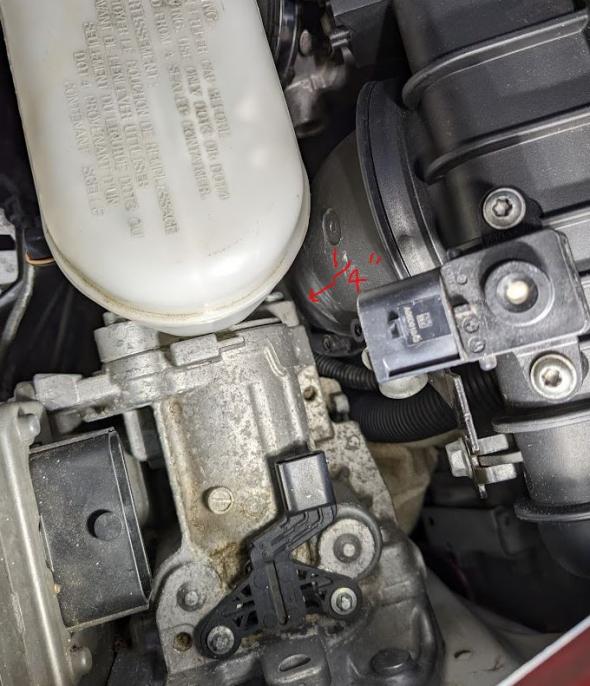

                              Posting this as a data point.... a Tesla brake booster will fit with full intake when the motor is on the E85 arms. This photo shows the booster with the integrated fluid reservoir, the cool kids are using the one from the CRV that is remote mounted and has oodles of room around the throttle body.
                              The closest point of contact is the DISA transfer tube thing where there's about 1/4". Slotting the booster outboard another 1/4" would help but not really necessary.
                              I'm not going to run this, I got Lee's dual MC boosterless.
