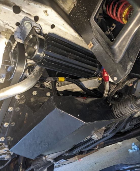

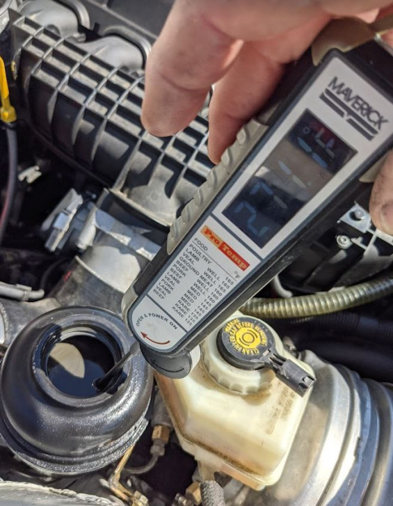

                      • hoveringuy
                        • Dec 2005
                        • 2742
                        #806
                        Great track day yesterday, Turn 2 "late apexing" at the Ridge. $300 for a few 30 minute sessions followed by OPEN TRACK from 5-8pm, it was an all-you-can-eat buffet of driving!
                        I'm getting used to the Mk60E5 ABS and it is amazing; it's the German hand of God.
                        I had also added a Derale heatsink power steering cooler and I was really pleased with how well it works. With the stock E90 power steering pump and pulley, back in the day, I was exceeding 300F at my first track events with the N52, plus the steering was overboosted. A reduction in pressure with a 100bar Cayman regulator got the temps down to 270F which is still hot.
                        I never saw anything over 200F yesterday and I will call this "sorted". My other option was to run a small radiator in front but I don't necessarily want the extra plumbing. Dunno, but this seems fine mounted on the frame rail and it's pretty out of the way.
ID:	10119660 Click image for larger version
ID:	10119662 Click image for larger version
ID:	10119661 Click image for larger version

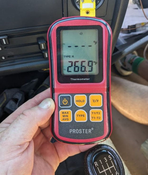

                        • hoveringuy
                          • Dec 2005
                          • 2742
                          #807
                          For the record, here's my oil temp at 75F ambient after a good 10 lap flogging. No oil cooler, just the steel pan. Temp taken by running a thermocouple down the dipstick tube.
                          I have an oil cooler in the wings and I'll see what the difference is...
                          • Caperix
                            • Feb 2018
                            • 195
                            #808
                            The temps are not horrible for synthetic oil. How much clearance do you have off the front of the oil filter housing? The oil to coolant cooler is the easiest to plum & heats up the oil quicker. There are top & bottom outlet adapters for oil to air coolers used on n54/5 that are a bit thinner & just need an adapters.
                            • hoveringuy
                              • Dec 2005
                              • 2742
                              #809
                              Lots of room and I've collected all the pieces to do the coolant-oil heat exchanger.
                              I'll repeat this exercise in the next several months to see what the actual difference is. Data!
