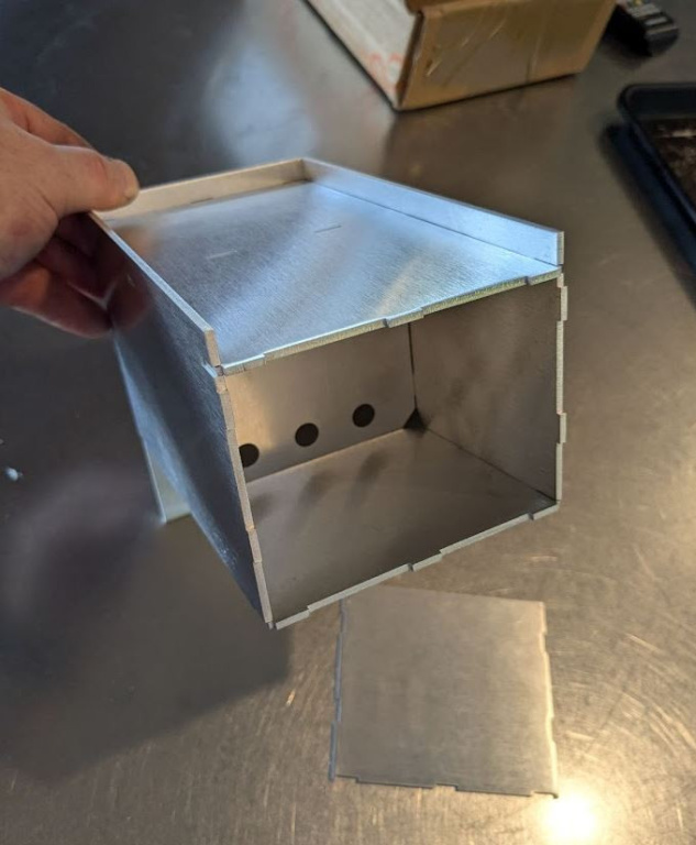

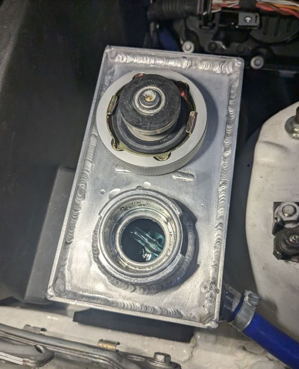

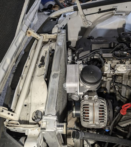

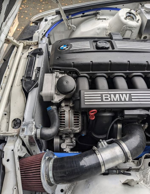

          A coupla small updates in progress....
          My oil temps without any cooling was running 265F at the track which is not horrible but I really need a cooler, so fitting the integrated oil/coolant heat exchanger to see how much it comes down. I'd be happy with anything below 230 and I can change to a dedicated oil cooler if I need to in the future (N54 style). Still almost an inch of clearance between the cooler neck and the radiator.
          Also, to make room for a potential revised intake I'm moving the coolant reservoir to the battery tray. I HAVE THE CAD FOR THIS if anybody wants it.. It will now tee in at the heater core, need to move radiator bleed nipple to the right side as well. It will be more-better.
          I also changed the VANOS solenoid O-rings while the radiator is out. Impossible to do with the radiator in. Very easy job and the old O-rings were pretty hard.

            I'm guessing expansion tank hose size determines the flow of water filling system minus the amount of air that can bleed back to it?
            Other than that no effect on cooling, I suppose it could be 3/8 or even 5/16 hose could be used in theory?
            I've thought about downsizing expansion tank hose size on some builds for packaging.
            Were those oil temps in the pan or at the Oil Filter Housing?
            @Zakspeed_US
            • hoveringuy
              • Dec 2005
              • 2743
              #816
              moatilliatta The outlet hose is still bigger than the bleed hose from the radiator, so the operational impact will be exactly zero. The practical impact will be that the system will take a few more minutes to fill, but my hose is smaller, shorter and out of the way. I also have a multi-level tree in the tank to help visually determine fluid level

                moatilliattaAlso, the baffle isn't there primarily to be a baffle
                That's just a bonus.
                It's a structural element because I have large, flat sides and 10psi really adds-up!

                  My mini-depot overhaul is complete. I'm pleased with the utility of the new reservoir, the level sender works great! I need to add a flow restrictor to the bleed line because the 3/8" line flows WAY too much (but it is effective)
                  Coolant temperature seems to take longer to come up to temperature, it's freezing outside presently, so that's a lot of the reason, but I also wonder if it's because the oil is now being heated by the coolant....?
                  I had a small weep from the (original!) coolant pipe O-ring, as well as small oil weeps from the also-original VANOS and cam sensor O-rings. Everything else looked fine.
                  Also a picture with the two styles of coolant pipe, with and without oil heat exchanger bleed nipple.

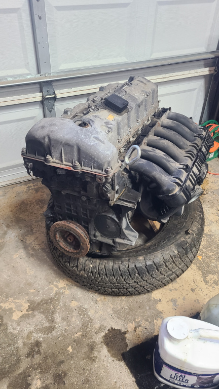

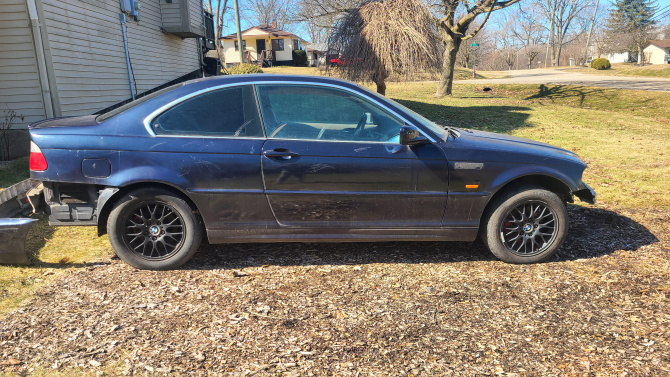

                      This is my first post. I'm pretty new here and I was shopping for an E30. I recently ended up getting an E46 chassis. I'm really interested in this particular thread because I plan to swap in an N52. I have a partial motor, partial harness and some modules. Apart from reading thru 55 pages to get the information I need, is there a summary of all the electronic parts needed to get the motor to start and run? This is what I have so far:
                      1. engine harness with small DME connector [x60002, x60003], it's missing x60001 and harness, which connects the CAS, EKP, accelerator pedal, etc.
                      2. engine harness with large DME connector [x60004, x60005, x60006, x60007]
                      3. matching MSV80, CAS and key.
                      4. throttle body for both n52 and n52n. I got the later TB because I want to go with MSV80, assuming it's a better DME. But now I'm reading that the MSV70 is easier. I can just buy another DME if this is the preferred DME.
                      5. N52 long block with injectors, coil packs, 3 stage intake and most of the sensors. Missing the valvetronic motor and accessories [alternator, electric water pump, power steering pump, tensioner pulleys]. Oh, also the O2 sensors.
                      From reading some of this thread, I will need the EKP fuel pump module and the IVM integrated fuse block. The main question is, can someone summarize the needed parts? I believe some of the modules can be deleted by coding or re-flashing the DME. My background is reverse engineering and I do a lot of this CAN protocol work. I hope I can add to this knowledge base and help create things that are needed to help the cause. Sorry, I'm not an E30 owner but I am an N52/E46 owner now. I'm looking for help on the N52 side of things.

                          Thanks, that helps! The part numbers especially to make sure of what I have or what I should have. I grabbed an accelerator out of a later E46. Will this work in place of the E90 pedal or does the pedal have to match the throttle body?
