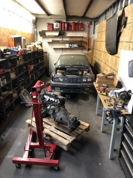

            I have an entire Z4 to pull parts from and am debating having the ECM tuned right now. My first goal is to get the engine in, running and enjoy it for a while. Change intake and exhaust and hopefully find some MILV's at a later date. There are several items that require ECM tuning and if I cross any one of them then I will likely have others done. Is this a correct list of things that would prevent the ECM from properly running the engine:
            • Remove secondary 02 - might be able to cut and rotate and shoehorn OEM exhaust into my car. Custom exhaust manifolds if I have to.
            • Change intake. Switching to N54 intake or fabricated intake requires tune for performance reasons, or is the ECM looking for DISA? Planning to use OEM intake to get car running. Change things later.
            • Delete CAS - must use OEM key if not deleted. I have both keys. Bit of a pain to get the wiring out, but it is available.
            • EKP controlling fuel pump.
            • Variable speed Fan.
            I have the engine and trans out of my E30. I have the engine and trans out of the Z4 with the complete wiring harness still attached. I have access to fabrication resources. I do not have time to make custom exhaust and things if I can get this to work without doing it.
