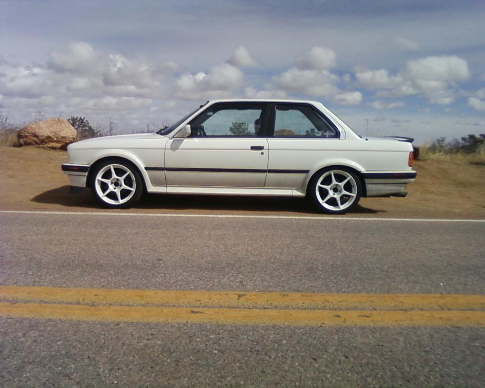

              My wheels (17x7 kosei K1's)

                Originally posted by CrazyPrime
                would 17x7.5 e35 fit and what would be the recommended tire size?
                I'm at ET25 in front and ET15 out back, and run a 225/45/17 on my 17's, which is a huge tire, and only rub out back on launch - with unrolled fenders.
                If I went down to a 205/45/17 I think I'd be happier, and that's what I'd recommend. Welcome to input, however.
                91 318i | 87 535iS
