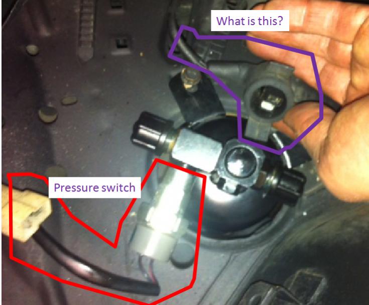

                So, my old r12 dryer had two pressure switches. My new 134a dryer has only one switch. should i just double up the wires both going to the same switch?
                Everything else is done so i'm stoked to get this thing charged.

                  #143
                  further pics of my pressure switch question.

                      #145
                      That connects to another pressure switch. pre-'91 e30s had two separate switches.

                        #146
                        Ok, I've got a High+low pressure switch in one housing from an E36. Pic attached here. Which connector is the high switch and which one is the low switch?

                            #148
                            Thanks
                            Check for continuity, the low pressure would be open circuit with the switch uninstalled. The High would be closed.
