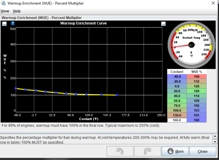

      Next, pin the TB open enough for the car to idle in it's own (if it doesn't already), then go through the warm up tables and adjust.

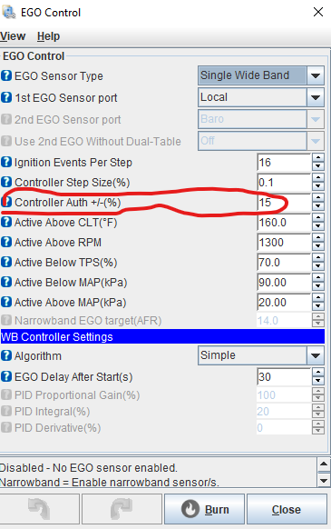

      Make sure the o2 feedback authority is 0
      Is the o2 feedback authority the same as controller authority under EGO control?

      and warmup tables being Startup/Idle > Warmup Enrichment (WUE) in tuner studio?
        Sorry if these are stupid questions, I have never touched an ECU before ​​
        You got it on both counts.

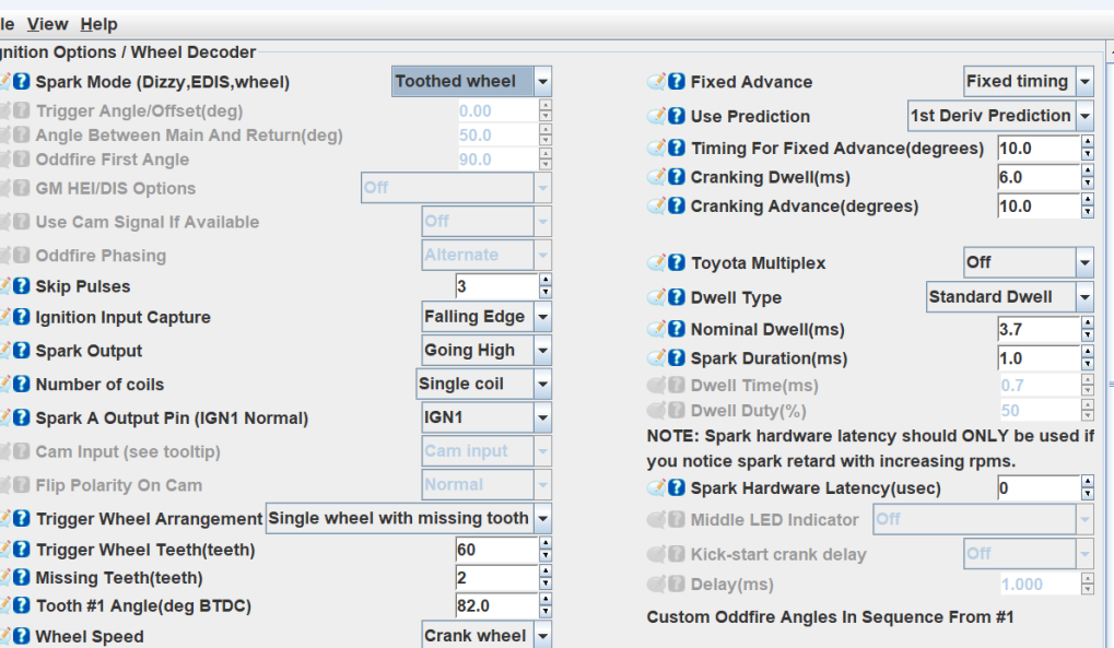

            1. Bought a new timing light and checked the timing, at temp I wasn't too far off the default map, changed tooth angle to 95

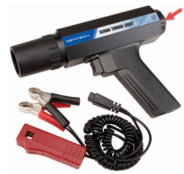

                  Are you using a timing light with an adjustable angle, or standard?

                    Adjustable, this one from Harbor Freight

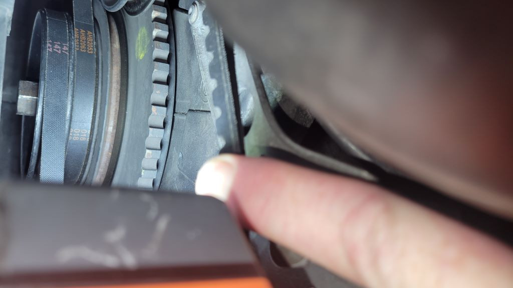

                      Can you snap the reluctor wheel on camera? The alignment pin has peaked my interest. The late 1987 325e is kinda unique.

                        Here is the best I could do, moved the alternator belt to the side. Interesting thing, I checked the timing again and it lined up most of the time. The light did not keep a consistent tempo, and not meaning speed, as the idle varies a little. I mean like atrial fibrillation in your heart, it would blink blink blink at a regular interval and then skip a beat. Which is consistent with my stock DME where the idle felt "lumpy". I wonder if the Dizzy is going? It's original.

                          I had that exact timing light and I had issues with it not blinking every time leading me to think I had ignition issues. I bought a quality timing light that did not have adjustable timing and set my fixed timing to 0. I found I was 2° off the harbor freight light. I think you can even get a timing light from auto zone lone a tool. I'd try a better light.

                              I couldn't find one to rent so just bought this Inova one. Nice to see RPM on it so I could hold the throttle body open, hold at 2k and check timing. Big difference over the Harbor Freight one, plus doing it at 2k. I was off 10 degrees, I'm now at a tooth angle of 82 ForcedFirebird . That's with fixed timing set at 10 degrees in tuner studio. I'll drive around with "Tune Analyze Live" running again now that I have the correct tooth angle. Thanks guys!

                                Nice 82 sounds much better. Make sure you turn it back from fixed angle to use table now that the timing is set.
