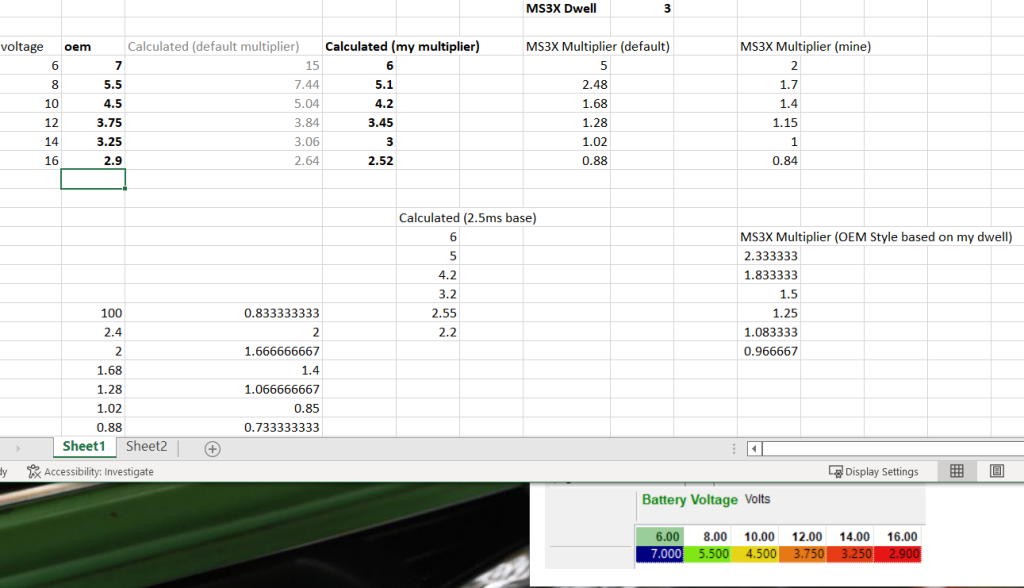

    School me on technicals as I am uncertain how to interpolate this graph into my LINK ECU. Obviously I would like to find and load the correct settings. Does anyone have any experience with this? It seems to me it is a fairly newer modification and there is not much detail as to how to set this up correctly. I want to run the updated coils simply because they are cheap, more powerful, much newer and they can handle the demand of FI far better than OEM Bremi coils.I am doing this modification to get the most efficiency out of my engine and because I have ran into several builds documenting issues with spark delivery at high RPM high boost combos.
    I have searched for hours and found guys using this conversion saying the dwell settings for the Bremi bolt down coils will function the B58 coils with no issue. I find this very hard to believe as the ignition coils that are 20 some years old have nearly nothing in common with the newer technology.
    I have purchased the conversion plates and harness plugs from this company : https://www.facebook.com/tunertechllc/
    After some research I found this which gives some detail on what the settings are (or could be) I cannot confirm with any additional info that this is actually correct.
    Hello everybody, I am in the process of installing B58 coil packs on my turbo E46. I just finished the hardware side of things and am moving onto the tune. I was able to get the dwell times through a damos file, but I cannot find if there are dwell times for multispark. Any help would be...
    Discuss.

    Figuring out dwell time, you measure the current as you vary dwell times at different voltages to target a primary current that matches the published spec. If you don't have a published spec you measure temperatures and hope for the best. Measuring spark energy and voltage is a little more difficult, but the best possible way. You may find because of the characteristics of the coil that you see a drop in secondary voltage or spark energy past a certain dwell point, even with the primary current within spec. Coils are still coils, it's just down to them having more refined windings and cores, and what is economical for mass production.
    Top down view, the numbers in the map you posted look reasonable, they're very similar to M50 numbers from the OE DME tables. Unless someone else has done the legwork for you and posts their tables or bosch has published a datasheet for their B58 coils (maybe email them?), there's one way to find out for sure:
    A verified map from a Supra ECU is the next best thing I suppose, but you don't know what modifiers are applied to that dwell number unless you can dig through the software yourself. It's always possible that the numbers you see in the table are subject to some other modifiers and that the actual dwell under boost or cruising is different from what you'd get just reading that one table.

        I went with a base dwell of 3ms and my own multiplier table to be conservative.
        If that old forum post is to be believed, it looks like the original ECU dwells the coils longer then 3ms (until 7000rpm) so I am satisfied I won't burn out my coilpacks with my numbers.

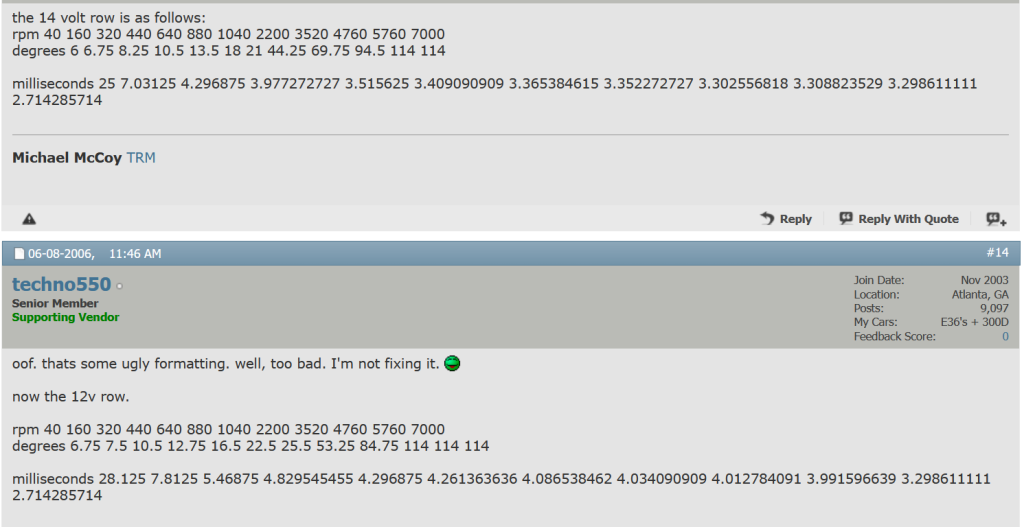

        And an old forum post for more reference info:
        https://www.bimmerforums.com/forum/s...il-dwell-table
        Click image for larger version Name:	Dwell2.png Views:	0 Size:	147.4 KB ID:	10079893

          Thanks Panici! I too stumbled on that thread looking for Bremi OEM coils for m5x just to compare what I am running in LINK to stock.
          I found these tables to be interesting. Post claims these are stock DME settings.
          Here is my current table with Bremi coils. Note (not one single issue with coils so far) This is the table that comes in the G4X e36 base map plug in from Link ECU.
          After doing some more reading I found that operating MS @ 14v should be 3.5 or under... Still no hard info on B58 coil dwell other than what has been posted above. I did find one guy on youtube claiming the 413 red label DME settings for dwell will run b58 coils fine as they are " close enough"
          Not sure how I feel about that.
