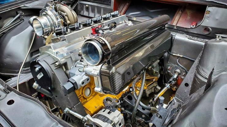

    So I was scrolling through Instagram and found a M20 that Ireland motorsports are making with a water pump delete plate to replace with an electric water pump from Stim.Tech and a replacement thermostat plate from someone else and noticed that it completely removes the hose that goes from the thermostat over the distributor back to the water pump and I'm just wondering if all the water hoses on the front of the engine are completely necessary? would it be more efficient just to have one hose going from the radiator to the engine and one coming back, or is there a reason for the extra hoses that I'm not aware of?

    It seems that you are not aware of anything lol.
    Water pump outlet is obvious in the picture and coolant hoses and even the radiator are not yet installed.

      Right, well I'll put it in a simple question for you then, would it work if you put a pipe or hose straight from the radiators lower outlet to the water pump, and a water pipe or hose going straight from the thermostat to the radiators upper outlet?
      The picture was just to show the bit that replaces the thermostat and the fact that it only has one outlet on it not three.
