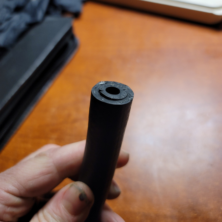

    Lift pump 12>8mm reducer replacement.
    Hello everyone.
    Recently did the single pump conversion on my 1987 325is. I noticed the reducer hose from the pump to the assembly had a small crack but thought the clamps would be able to hold it together.
    Unfortunately that isn't the case.
    Of course as many may know, the small hose is only available with the entire stock lift pump assembly and there is no other sources that I have discovered.
    I have found a couple sources in UK for the reducers but they are either not rated for fuel or are months out from possible availability.
    (Polyester) https://www.autosiliconehoses.com/si...inch-blue.html
    (Silicone) https://www.merlinmotorsport.co.uk/p...cer-sr12-8clbk
    I'm surprised this hasn't been asked more often but, has anyone come up with a better solution?
    I'm considering the possibility of casting a new part with SS300 silicone

        • LBC28730
          • May 2020
          • 58
          Originally posted by moatilliatta
          I gave up years ago looking for a replacement coupler... I've been bitten in the ass and lost a race because of that faulty reducer coupler. I cant imagine all the people who got stranded on side of the road from Airtex or Spectra drop in pumps because of this.
          Bullshit
          It occurred to me today, I'm surprised this isn't an issue with every single pump conversion, as the factory lift pump is rated at <5psi, hi volume, low pressure.
          I had a super simple idea that I am about to test, but I can't imagine why it would not work.
          I got a section of 12mm (.5") fuel hose and cut a small section of 8mm (.375") just tall enough for the height of the nipple of the pump.
          I put cut a section of the 12mm about 2x as long and then worked the 8mm section into one end until it was flush. .
          I put the 8mm id end on the pump and used a clamp type like you have shown (it seems that I don't know what they are called?). I then put the same clamp (21mm I think) on the other end as well.
          I just put it back in the tank and hopefully it will solve my issues of low pressure for no apparent reason!
          I'd cancel the order for adapters I ordered but I realized in retrospect they were the same size I used for the external pump deletion so I may as well have them on hand.
          Oetiker Clamp......I had no idea
          • LBC28730
            • May 2020
            • 58
            Great success!
            Pretty straightforward but here's a photo for those that are more visual:
