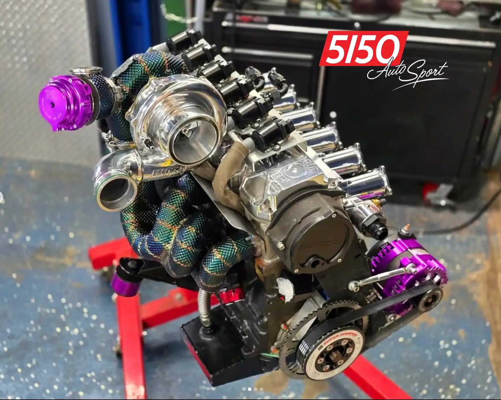

                            here is the 3.4 engine they claim capable of producing 500 naturally aspirated hp which is also nonsense, the generic claims are the same as for the m5x based stroker
                            5150 Bully 3.4L BMW M20 race engine build with forged internals, billet crank, ported head, and ARP hardware. 500HP NA or 1500+HP turbo, fully turn-key.
                            Increase displacement and torque with the 5150 AutoSport BMW M20 Stroker Kit. Proven 3.3L 3.4L setup with forged pistons and billet crank for high power.
                            • varg
                              Florida Turbo Man
                              • May 2014
                              • 3421
                              Wow those are some extraordinary claims. I'm incredulous of claims of over 200whp NA without good evidence, forget 500hp.
