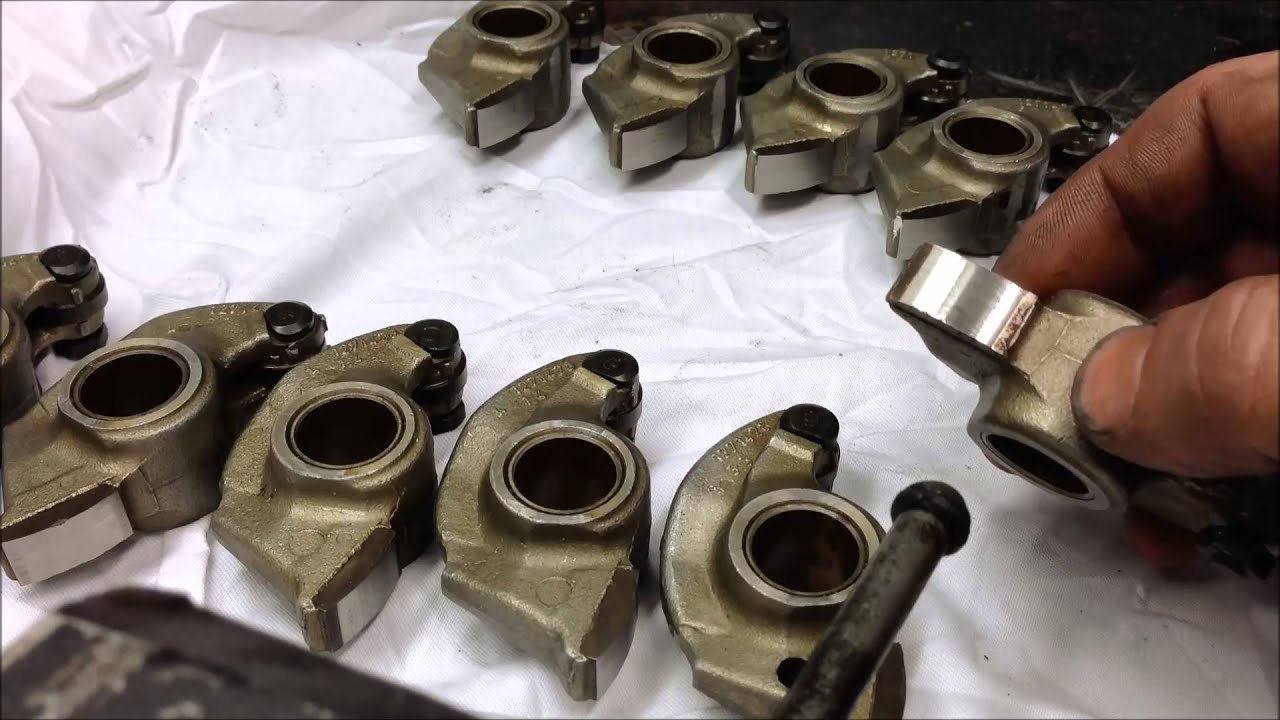

      I guess not enough demand on rockers for those or similar old school engines. I keep saving all old OEM rockers in hopes someone will offer good resurface job. ForcedFireburd used to do it (still does it?) but I didn't like his setup. He used grinder attachment that was designed for like Mopar 273 rockers (small pad that presses against the valve and not the cam), where grinding wheel rotates against the side of the pad, so I'm not sure how square and true that setup does the job.
      I can see something like this working well (link below) if the holding stand built to follow correct radius of OEM new rocker arm pad. At ~$20-25 per resurfaced rocker with the core, would be nice offering considering crazy prices for new these days
