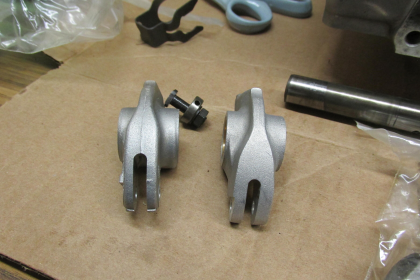

          they are thicker on the adjustment side and the eccentric arms. i'm running a set bimmerheads supplied. can easily see the difference.

                here's a pic from my build
                Click image for larger version  Name:	image.png Views:	0 Size:	206.3 KB ID:	10147182
                stock on left, hd on right.
                edit: i spun an eccentric on a hard pull and had no damage with an hd rocker. yes, i am that dumb. pretty sure it would have snapped the stockie.
