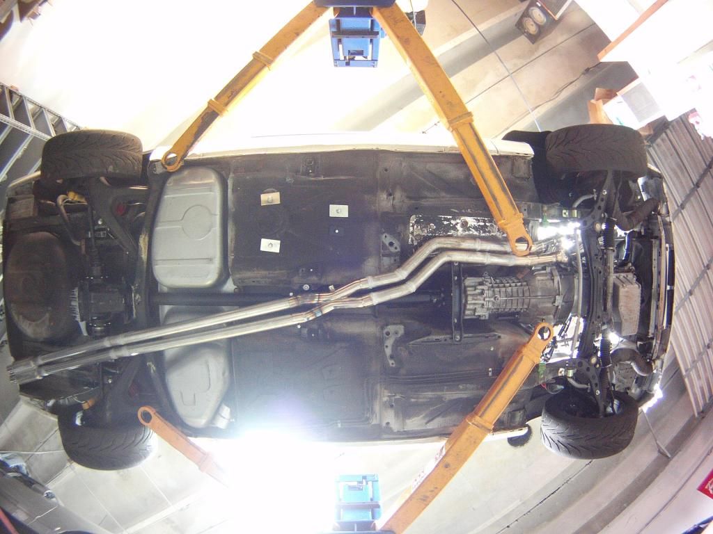

        Went with dual 2" exhaust, x pipe ~34" from collectors, twin 12" resonators.
        10am appointment at dyno.
        This one is staying Alpha-N Motronic 1.3.

            Originally posted by tinkerputzer
            That sounds sick! Cannot wait to see how it does.
            Post pics of the exhaust work if you can.
            Simple, effective and serviceable. The X-pipe that came with the headers are something to be desired. :(
                          Looks quite functional to me.
                          Is this dimension from where the primaries end/secondary begins to where the x pipe merges? Just wondering how precise the measurement has to be.
