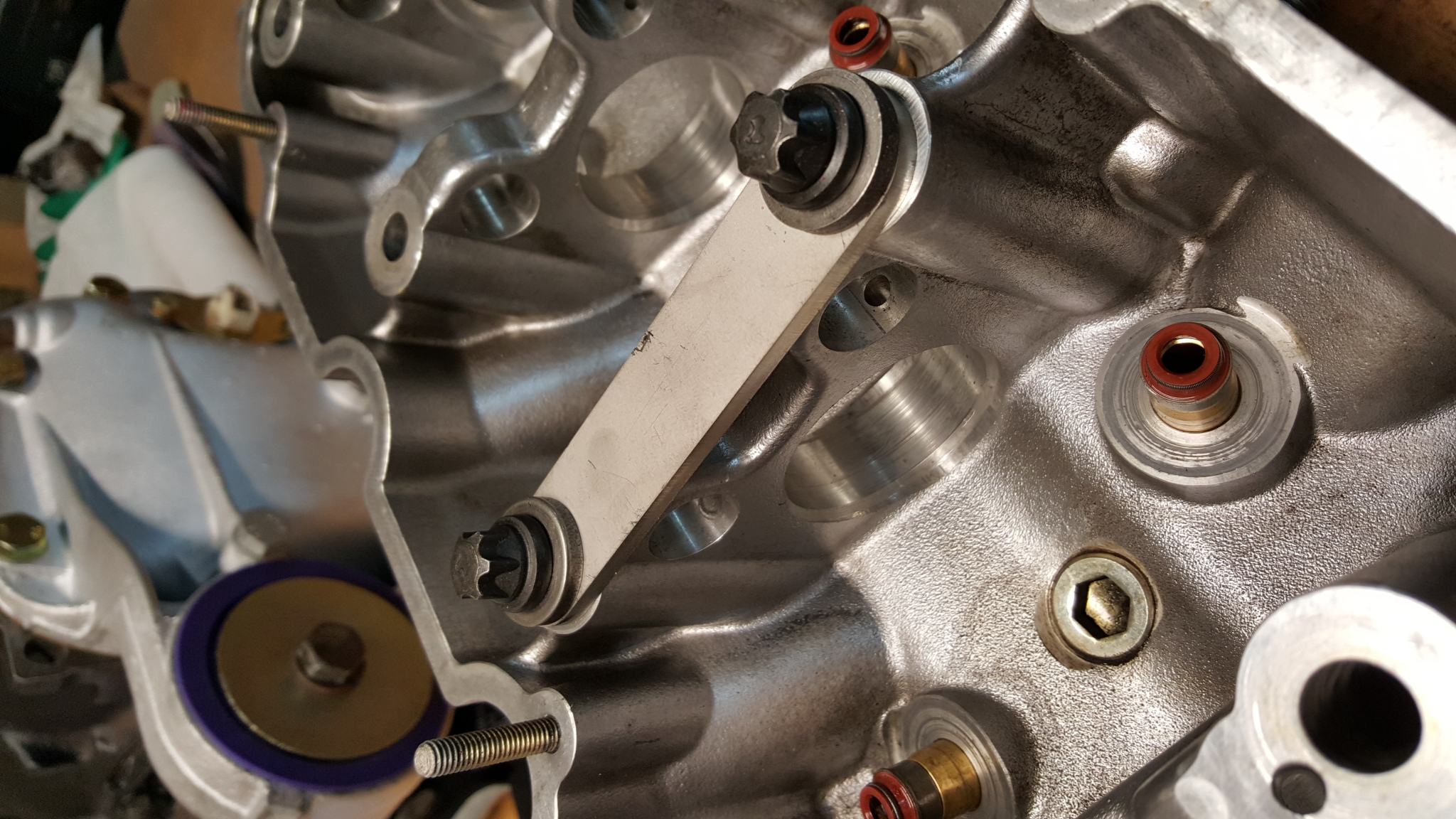

                    Ugh. First I grabbed the wrong folder from the dyno PC, so can't post any graphs right now, but that's not the worst part.
                    The vapor in the video turned out to be a developing problem. Got worse today, so opened up the valve cover when we got her back in the shop. Lots of milkshake on the back of it, but dip stick looks clean - threw the pressure tester on it and that stupid #6 cam journal cracked :(

                              Head is off, new core is being prepped/ported/machined. Owner was a bit bummed, but happy it was noticed now, and not after the coolant wiped out his new engine.
                              Worst part is, the old head was pressure tested and ran for a year before it cracked. Never overheated, but was abused.

                                #210
                                Omg, bad luck.
                                This happened also to my old engine the head cracked at the same place.
                                Then i rebuilt it and the head gasket blew out on 5th zylinder.
                                Now with my new build i try to reinforce the head as much as possible.
                                With Arp bolts and O-ringing an plates like the turbo guys do.........i hope it will help. Becase when the head will be fu...... up the next time, this will be the finish with m20 in my car and i sadly switch to another engine.
                                Maybe we should put all information together to research why it cracks and look out for possibilities to solve this problem......
