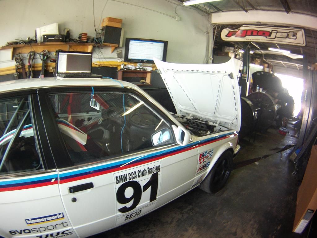

                    Norcal Spec e30 dyno (MCE tuning)
                    m20b25 1987
                    Stock 200K + bottom end with over 80 hours of lemons racing
                    fresh built stock head with all stock ports, stock cam and rocker arms
                    some chip I think turner
                    154rwhp on pump 91 right after a 14 hour race.
                    to gain 46rwhp without removing the block from the car....... that would be pretty impressive.

                      Dyno day. Run 1, pulled on dyno as it sat. Run 2 cut the P/S belt. Run 5 is Sssquid's file. Pretty sure this engine has never been opened, if it did, it was eons ago as the head is pretty filthy inside.

                        power and torque curves have all the right shapes and like many seem to be running a little leaner than ideal at the topend
                          That happens because the ECU stops reading higher RPM's before the rev limiter and the last block in the maps are carried through for fuel/spark. That can be changed, but since this was a Spec e30, it had an unopened ECU.
                          john@m20guru.com
                          Links:
                          • squidmaster
                            • Aug 2011
                            • 2666
                            My tunes actually have changed values for fueling and ignition all the way to 7k RPM, instead of stopping at 6200 like stock.
                            In terms of that tune, I think john said it was for the 19lbhr injectors? I've added a little more fueling to it in the past few months so that should bring the AFR down a bit more. I am for high 12's and low-mid 13's throughout when tuning, so this does look a bit lean.
                            All-in-all, not bad for such an old and beaten engine! I'm surprised it did dyno that high to begin with. I was expecting lower 140's.
                            • ForcedFirebird
                              • Feb 2007
                              • 8300
                              This was your OEM performance tune, very surprised the AFR's were so behavioral. Client put 19's in and been driving it, and was surprised it had adapted that much - still the common BMW lean conditions.
                              Idles and drives like junk though, just like everyone else who puts bigger injectors on without a matching chip. Didn't want to waste time dyno tuning this motor, already showed low power.
                              Best to date on an all stock motor was 157whp header and exhaust only car. It has the Racing Dynamics headers, true merge collector in reverse to a Vibrant 2.5" resonator, back to true merge into a Billy Boat rear section, OEM induction, cam, rebuilt head, dyno tuned.
