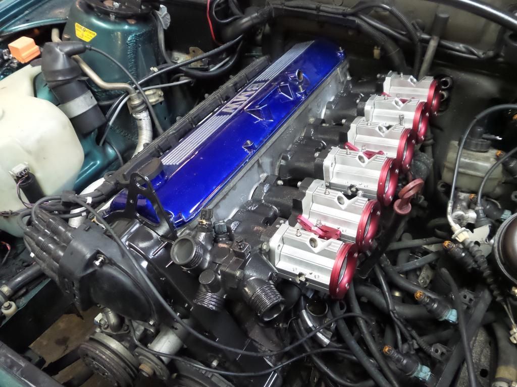

      We are tuning the stock Motronic. Currently working on another m20 with ITB's. We have the car running, and are just getting into the tuning stages on this one (pic from last week, it's all buttoned up now)...

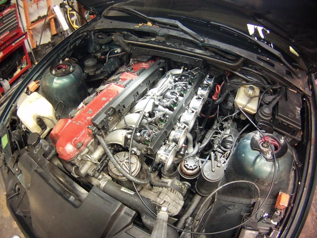

      We will soon have 3 different setups. I also have ITB's on my m50 powered e36 beater, also running stock Motronic...

        Ok need more explanation here... What type of load sensing are you using? Map, alpha-n?
        Are you reflashing the motronic? Or using a piggyback chip?
          Alpha-N, no load compensation. I use an emulator to tune on the fly and a chip burner to burn the final tune.

            #65
            Wow awesome! Did not know it was possible to make stock DME run alpha-N with just a chip burn.
            How is the alpha-n driveability? Is it near stock quality? Where are the sacrifices?

                            Can you explain generally how you are running motronic AlphaN ?
                            Are using the 0-5v tps in place of the afm and tuning around it or is it more complicated?
                              Because I'm using a 0-5v TPS in place of the AFM.
                              m50 TPS wired in place of the AFM, angled to read the same voltage at 0 throttle as the AFM did at idle. Using Tunerpro's tracing, I verified the ECU is seeing basically what it would if the AFM were there. I think it's because the AFM door would open more gradual than the 5v signal is moving with the M50 TPS directly on the throttle shaft.
