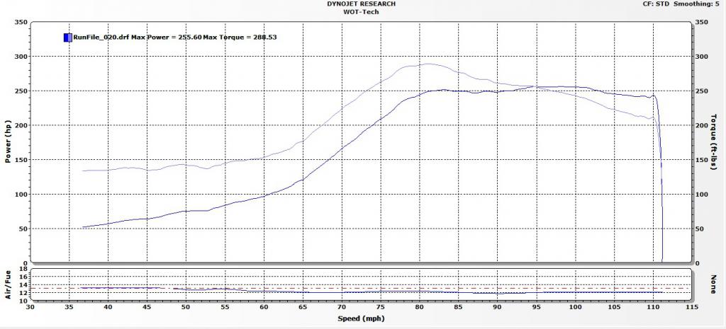

              Originally posted by ForcedFirebird
              Ironic you asked. If you look at the screen shots, they are in EEC.
              Ah, sorry... my bad. It seems that we have so many correction factors, hp standards, measurement styles (whp or transmission losses corrected) that it makes me crazy. Thanks for sharing these!
              • ForcedFirebird
                • Feb 2007
                • 8300
                No harm, no foul. HA
                With low power engines, it's not as much of a big deal. When changing correction factors on a ~150whp car only changes the numbers a few HP. Naturally when you get to higher HP, the differences are large since it's a percentage based formula.

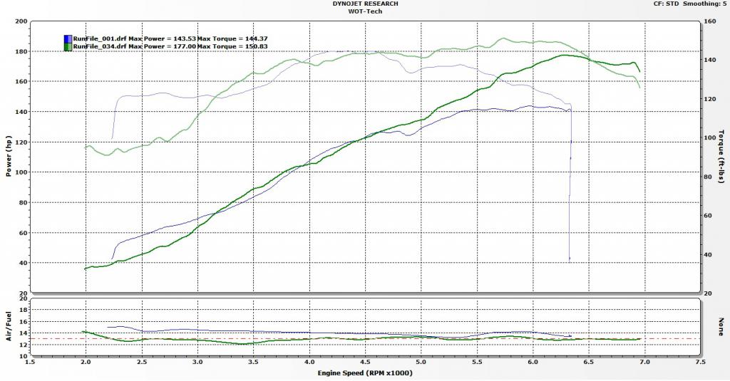

                  Same car in post #3 with our head, 272 cam and RHD ITB.Check out the TQ at 2500 rpm, it's more than peak in the base lol.

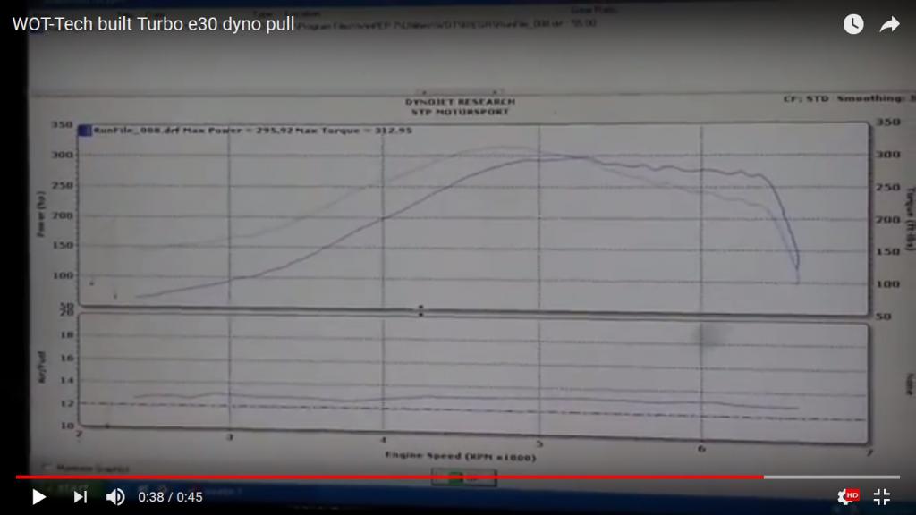

                          Kidding aside. I base the cam on the compression. When you have less than 10:1, anything larger than a 272 puts the power band higher than the m20 head will make power.
                          Here's one of the lost dyno files, but realized we focused the camera at the dyno, woot
                          Stock 1988 seta engine with fresh rings, bearings and rebuilt head. Stock cam, eBay clone of a to4e/super60, spiked to 13psi, then held 12 stable. 524 TD manifold with a long adapter in between it and turbo to use a 38mm external gate. 3" DP, stock-ish exhaust with cat (yes, choking it), but he moved to Cali and wanted to be able to convert back to stock if needed.

                          Not sure why the youtube embed isn't working anymore on vbulliten, but here's the vid...

                            What causes the waviness in the curve? Is it from the restrictive exhaust?
                                More than likely. I played with the tune and couldn't smooth it out. Have a feeling there was some kind of pressure oscillation going on.
                                EDIT: It also could have been in part due to the manual boost controller. 6psi spring, it would only make 13 in a spike, then fall to 12 with the controller wide open.
