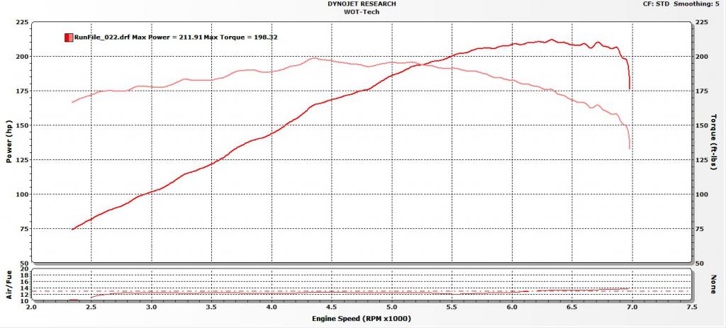

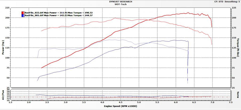

    Same car as post #3 and #23, but added a lightened/balanced/blueprinted 2.8 rotating assembly (has heavy 130mm m20 rods at 550gms), 2mm shaved block, 9.5:1 compression. We played with the runner lengths on the ITB's and got a ma peak of 217/202, but it was so peaky. This was the settled tune and runner length (most area under the curve).
    Overlay from when we met the car to current status. Trying to talk him into a larger cam. Even though the compression is 9.5:1, the RHD ITB's are great at cylinder filling and believe a larger cam would help this one out...
Name:	28itbm20 before and after.jpg

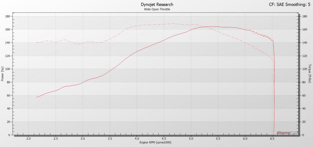

                            Here's the graphs from Sat.
                            81mm crank, 130mm rods, b25 pistons, .080" (2.03mm) off the deck, stock cam (and cam gear), in house rebuilt head, .035 quench, bored throttle body, extrude manifold, eBay headers, single 2.5" exhaust through 2 mufflers. MS1 with a smooth elbow pipe, cone filter.
                            81mm crank, 130mm rods, b25 pistons, .080" (2.03mm) off the deck, IE 272 cam (stock cam gear), in house rebuilt head, .050" quench, stock intake/TB, stock exhaust manifolds, single 2.5" exhaust with a single resonator. Stock ECU re-mapped at the dyno.
                            I believe this car "should" have made more power, was actually a little disappointed. Later after watching a video sent by a friend, I can hear a lot of diff noise that was impossible for me to hear in the car while tuning (one car bay with a dyno in it). Doubt we will bring it back to the dyno, just rebuild the diff and send it racing.
Name:	22 endurance car.jpg

                                It's amazing that both graphs are basically identical upto 5000rpm.
                                So the first has
                                - standalone ecu
                                - header
                                - exrtrude hone
                                - bbtb and fine style inlet
                                - tighter squish clearance
                                But the second has a IE 272, is it regrind or Schrick knock off ?
