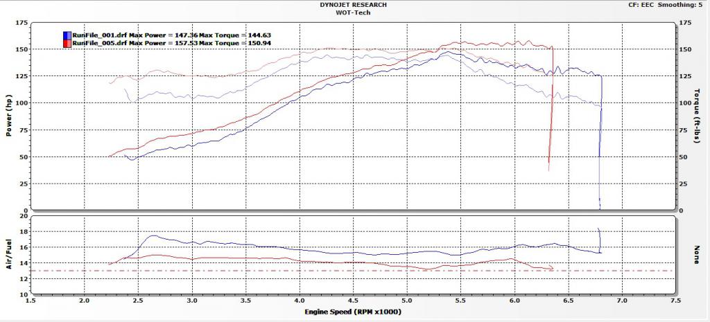

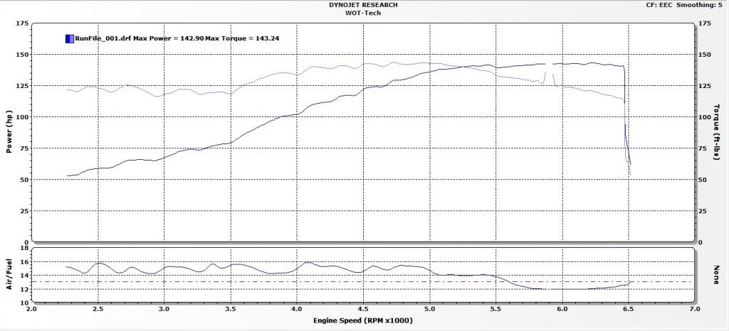

    To start, a bone stock 200k mile 325i, WOT switch on the TPS was inop, so it's weak on power. This is what happens when the m20 TPS goes bad and the ECU does dot receive a WOT signal. The ECU stays in closed loop and reads the o2 sensor, which "should" be ignored at this time. Note the AFR's.
Name:	m20 bad wot tps example.jpg

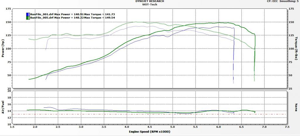

    Here is what happens when the TPS WOT switch is functional. Note the power increase and smoothness of the AFR curve.
Name:	m20 bad wot tps fixed.jpg
    And overlay for the dramatic effect....
Name:	m20 bad wot tps side by side.jpg
    Don't go to the dyno to see how much power your 30 your old engine is making without checking up on it's condition. All to many times we see things like this on "perfect running condition" cars.

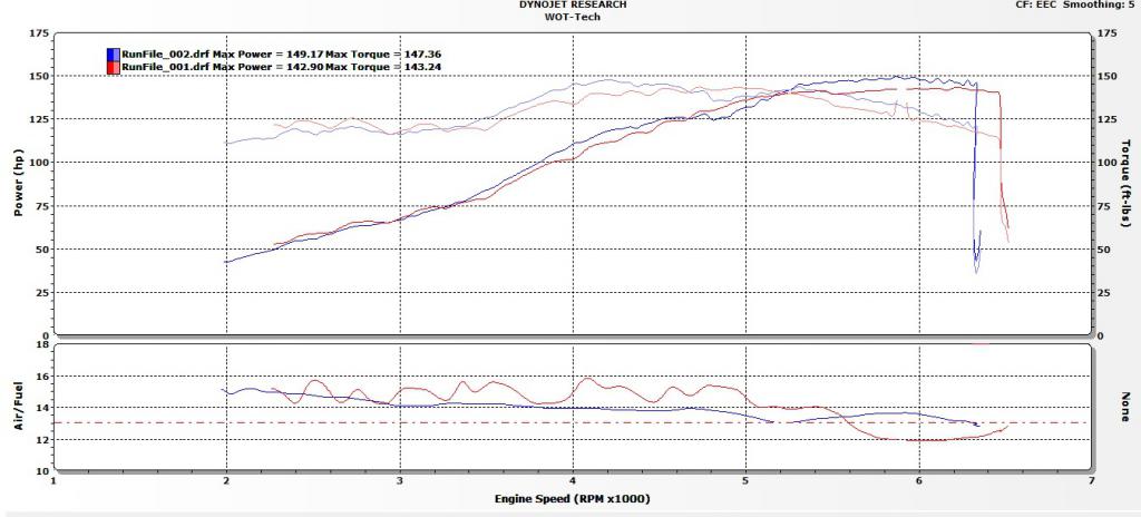

      Here's a tired engine. All components working properly, but it had 155-160psi cranking pressure.
Name:	worn out se30 160 155psi.jpg
      Amazingly, just a quick map of the Motronic actually did something on the poor guy.
Name:	worn out se30 160 155psi with chip.jpg

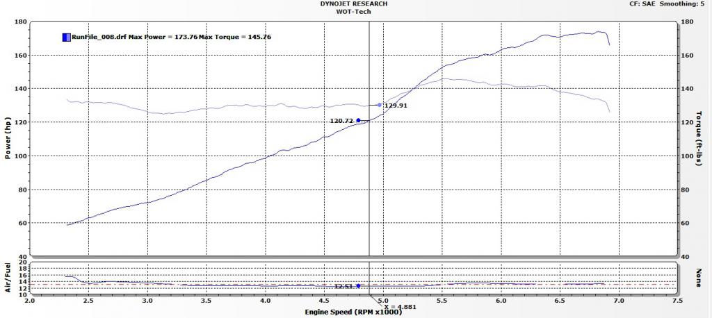

        Take an m20, add an m52 84mm crank, 130mm rods, and 84.5mm pistons, but leave the block at full height (no bueno imo). 272 IE cam, basic rebuild beyond that (stock ECU).
Name:	84mm stroke 84-5 pistons 130mm rods full height block.jpg

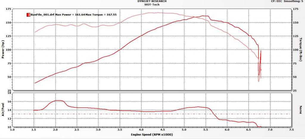

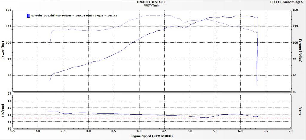

          This is a typical Spec e30 freshly finished. Guy built his car from a street car. Just went through and made sure everything was tip top (so was implied). After a couple hours of replacing a couple faulty sensors, adjusting throttle cable/TPS and the like....dyno pulls later. (EDIT: he had a "cheater chip" that made less power than stock, just made noise until 7k tach indicated)
          I consider this a healthy example of a used up m20. No PS, no AC belt, Spec e30 exhaust (open 2.25" single with 14" resonator), but not far off of a fresh rebuild.
Name:	typical spec e30 dyno check and tune up.jpg

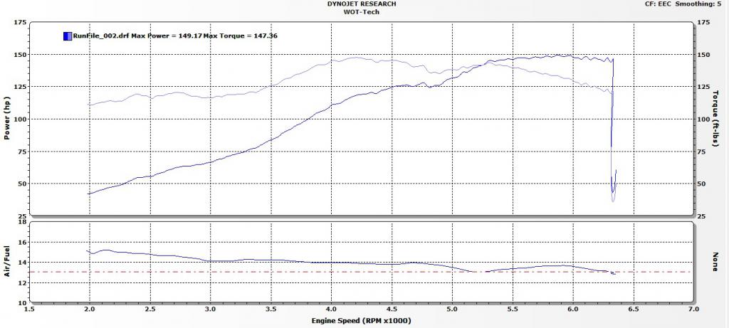

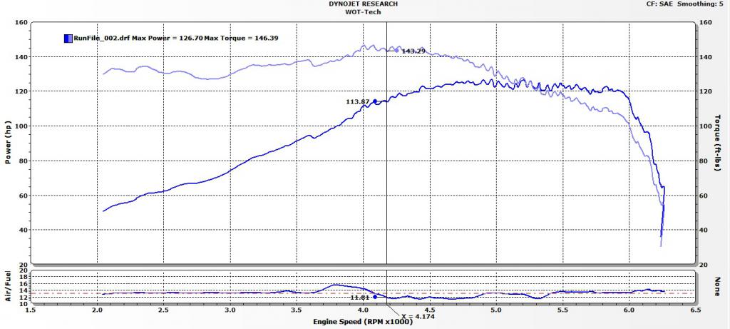

                      Here is an eta 2.7 with 885 head and 272 cam a client brought in to chip tune. They normally make a tad bit more that this, but not by much (~135hp/150tq or so). As you can see the top of the graph gets bumpy, which indicates an ignition issue, so we didn't waste the dyno time. He never did come back before selling the car.
Name:	eta with 885 head.jpg

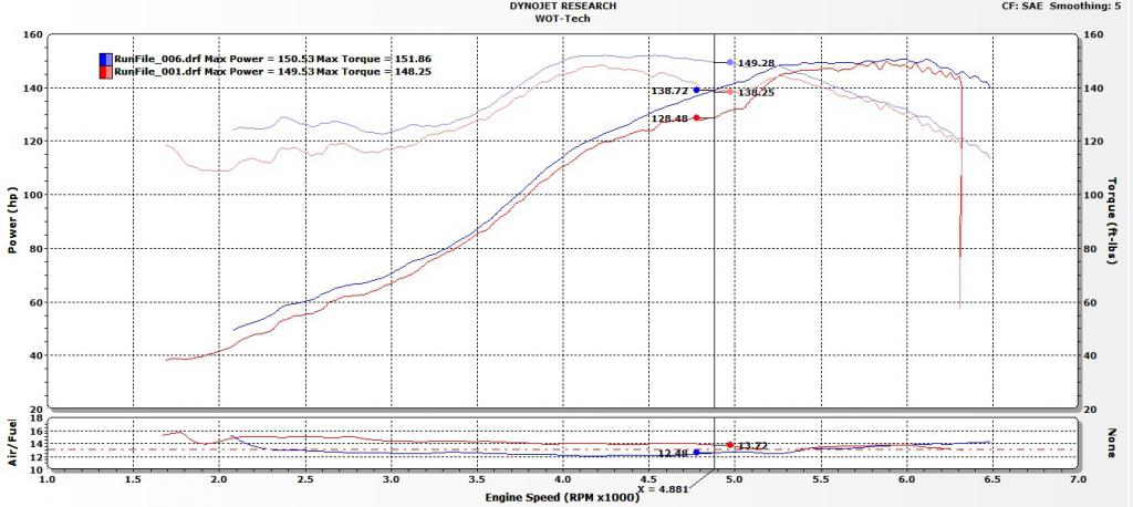

                        A well used m20 we put a fresh head, Racing Dynamics headers and a nice exhaust. This is before/after chip tuning. As you can see the peak power moved only slightly, but power under the curve is increased.
Name:	m20b25 with RD headers tuned.jpg
