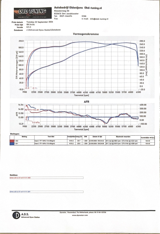

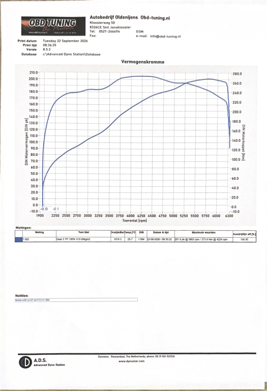

                    Here's my dyno chart from today, M20b27 stroker in this case.
Name:	OBD TUNING.jpg
Name:	OBD TUNING 2.jpg
                    engine completely rebuild.
                    crankshaft, flywheel and pressure plate balanced together.
                    lightened flywheel.
                    Conrods and pistons weight matched.
                    Did some excessive running in procedure to get the rings sealed.
                    decked block 2 mm to get compression up to 9.5
                    81 mm eta crank and 130 mm rods
                    325i late model pistons (CR 8.8:1)
                    885 head
                    Schrick 272 cam (new)
                    Nuke performance camwheel
                    bosch 4 pintle injectors
                    standard exhaust, type 1 version with 02 sensor in pipe for cilinder 1-3
                    standard valve springs(double)
                    HD-rocker arms
                    Running on standard motronic 1.3, went over there to get a new eprom chip dialed in, but that wasn't necessary.

                      That is basically the same/similar to a 2.7L Alpina C2/B3
                      • MWe
                        • Feb 2026
                        • 14
                        #176
                        I admit I took a bit of inspiration from the Alpina recipe.
                        Future improvement is a complete exhaust system, should bring the power up to C2 spec (210 hp), preferably supersprint 2x45mm full system.
                        but happy for now, shows that a 2.7 is a nice option still imho, but it takes a bit more work.
