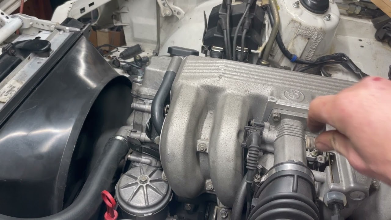

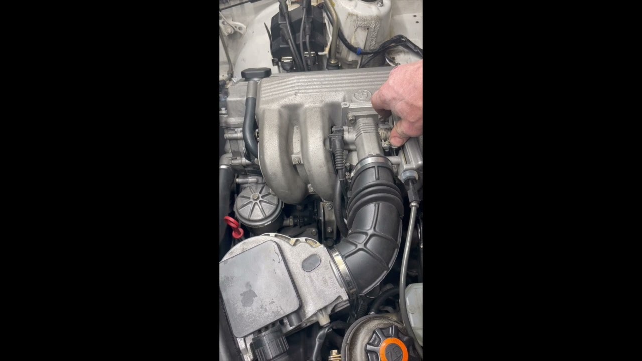

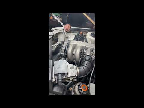

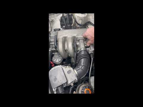

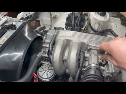

            Last night r3v wasn't available to me. Whether a local connectivity issue or what, not sure...
            Also, each time I try adding videos to my original post it trashes my photo links. So, I'm redoing it (for the 4th time) and just posting videos here..
            First start - very clattery
            After a few runs and it's much quieter
            Here is a cold start video from yesterday morning. Interior of the car looks much worse than it is. I have the cluster out because I'm waiting on new SI batteries..
