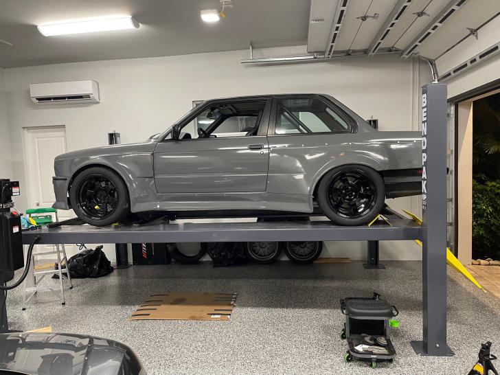

          Doesn't look like this place gets much traffic anymore, but I figure this build started here so may as well end here. The car isn’t truly done (i guess project cars are never truly done...) but this is probably how the car will remain for the foreseeable future. Only question mark is the rear bumper - I didn't like the fitment of the one I had made, so just wound up re-using the stock rear bumper. Looks a bit goofy but oh well. I'll get some more pictures up this week, but here is a quick one of how it sat after the final wrench:

            Need more deets.
            I like the rouge diff cover, that is on my to do list.
