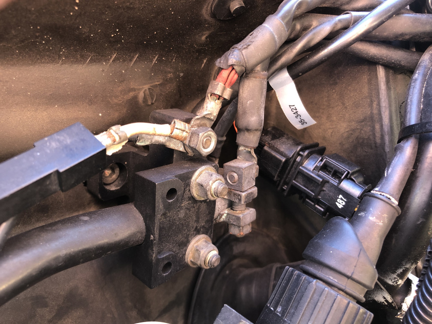

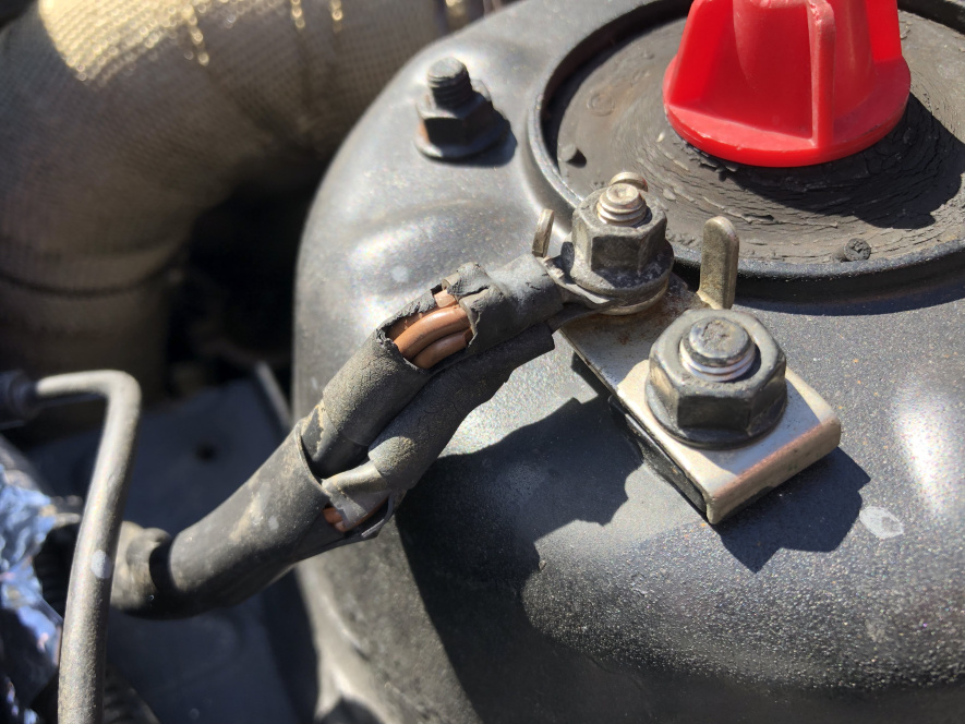

                My car is newer than yours and modified, a '91 318is with a '91 325i convertible engine and harness in it, but this is what I have:

                Ignore the white wire on the top terminal in picture two, it's an add-on. There are no wires going to my valve cover, It has been too long since I looked at a stock car to recall if there are supposed to be any.

                        I will send a picture of that i have on the positive and negative terminal in a few. cleaning up. I have strong suspicion it something in the back of the car.
